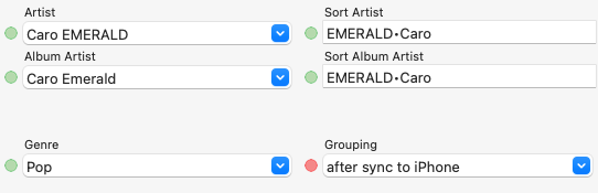

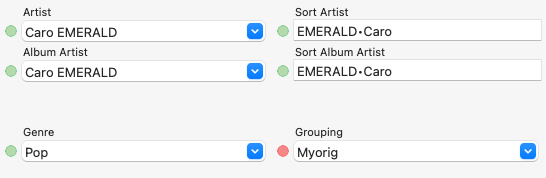

Not good news.
I deleted Caro Emerald from the iPhone and then copied a single track (from CD, not actually one purchased from the iTMS) up to the iPhone using iMazing 3. I then downloaded it back again (to a separate location) to compare.
The attached screenshots show it has been changed as I've previously stated. 🤬
So either iMazing is doing the same tag munging, or the iPhone is somehow responsible for it.
It occurs to me that there could be some record of this Artist being maintained on the iPhone, even after deleting all their media. However, software is editing the media file and altering the tag. Is that actually being done by the iPhone? In which case is it simply using that left over data or is it checking on-line in iTMS and updating the file with what it finds there?
None of this should be happening. How dare Apple modify MY metadata.
