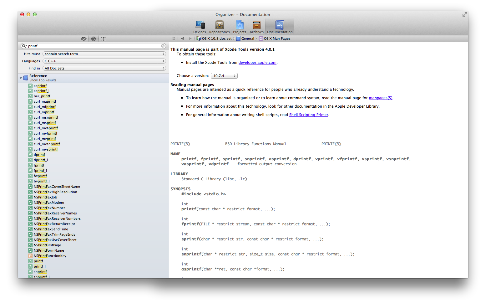

I was just using that as an example. My setup so heavily customized, it's possible that man 3 printf wont work for you for some reason, don't know. Xcode does have access to these man pages though. Xcode>Window Menu>Organizer>Documentation>Search for "printf" or whatever other C function you're curious about. Alt-clicking works too.
I included a screenshot of what you should see.
