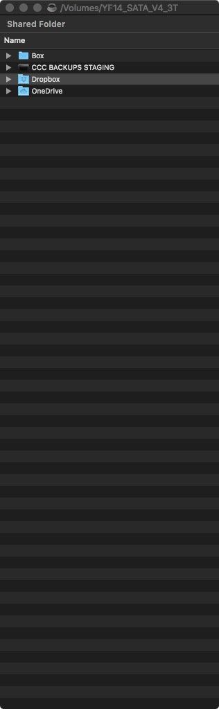

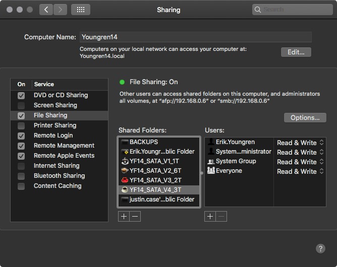

On a Mac you would open System Preferences>File Sharing. Click the plus to add what you want to share. That can either be a drive or a folder. In this case you probably just want to share the Dropbox folder. So, you'd click on that and share it.
Screen Shot 2022-05-30 at 17.37.21.jpgScreen Shot 2022-05-30 at 17.45.08.jpg
The pics above show one of the drives on my MacPro being shared. That means I can mount the drive and access the Dropbox folder from any Mac or PC on my home network.

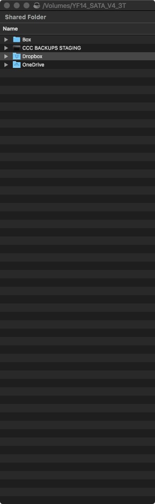

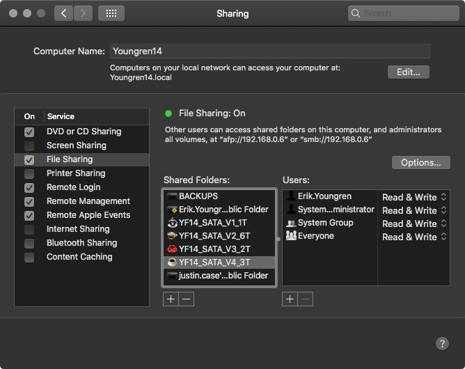

View attachment 2011477View attachment 2011476

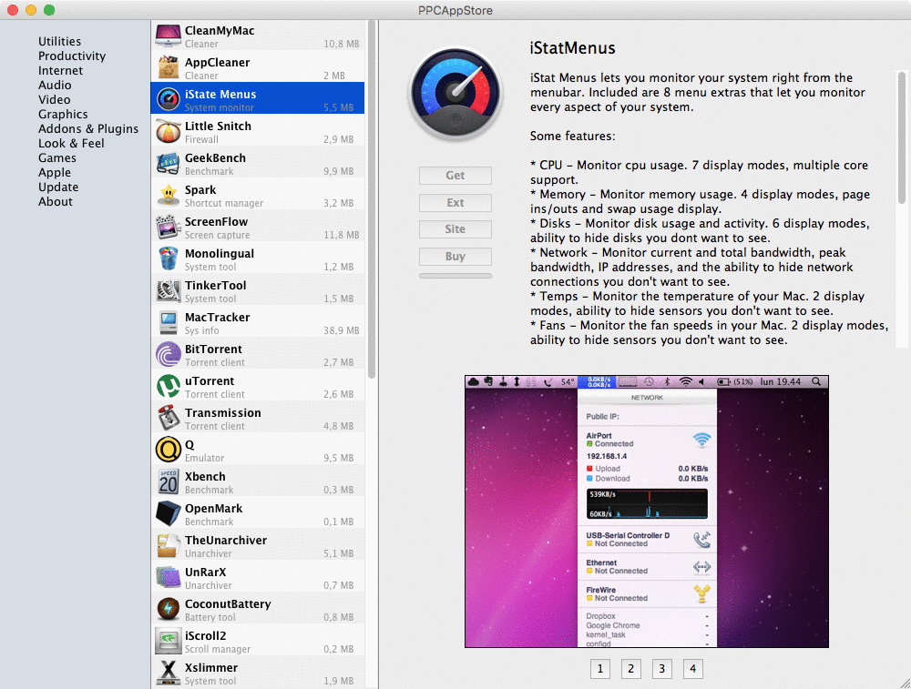

So the patched Dropbox from ppcAppStore doesn't work anymore I take it then?
I didn't realize there is an app. I'll give it a try tonight
@Czo was maintaining a PowerPC Dropbox app for us for several years. It got to be difficult so he dropped the project. But we got at least three or four years out of it.
I would be surprised if the app in the app store link worked. I could be wrong, but this is the first I've heard of there being such an app there. It might actually be Czo's work, IDK.
No, it's a reference to the original PPC Store from a few years back.
