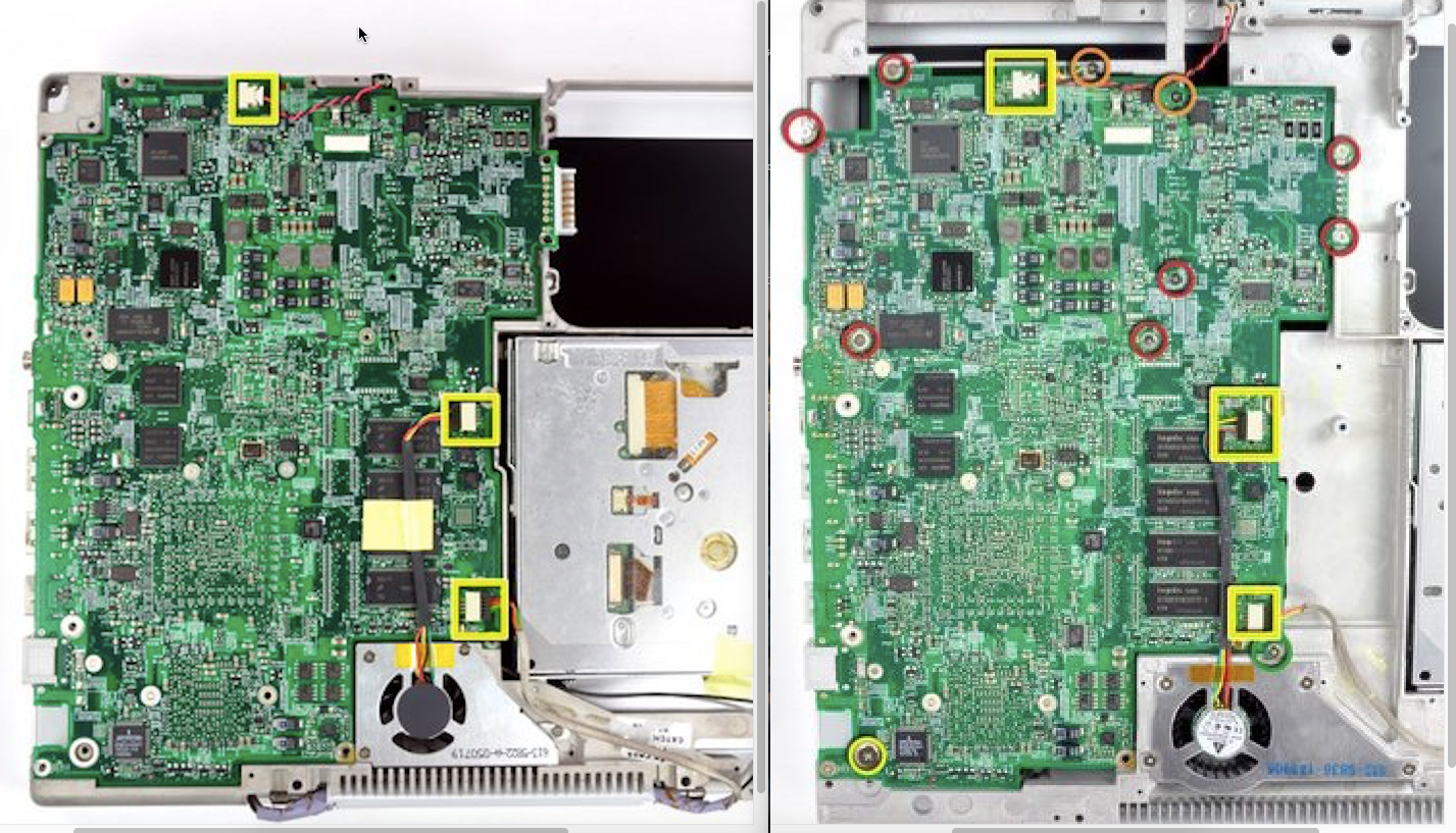

LogicBoards pretty much look the same. Screen resolution is the same on both the 12" and 14" iBook.
But: the battery-connector is kind of a problem, when it comes to swapping boards between the 12 and 14" models ... 🙁
Got these pictures from iFixit.
12" 1.33MHz vs 14" 1.42MHz
12" vs 14" early iBook G4

The rest of the board looks pretty much the same - size should be the same as well, since there's some spare place around the board in the 14" models, while within the 12" iBook the logicboard fits in pretty tight.
Did you manage to cross-replace a board? I mean, how did it work out with the battery-connector?

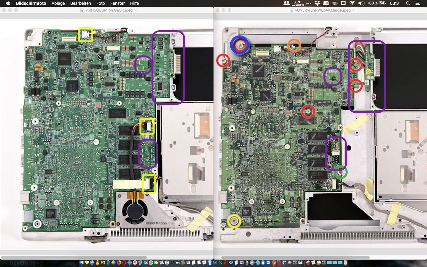

On a second look, boards do have a few more differences (marked in lilac color). @AphoticD is right: the 14" board certainly won't fit the 12" iBook ...
