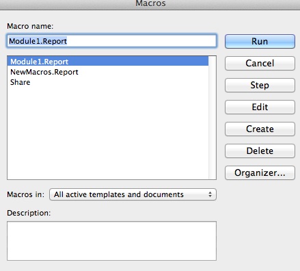

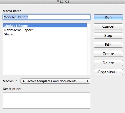

I'm having difficulty with new macros.
I created the first one "Share" and then the second one "Report". I simply copy/pasted the first script into it, clicked edit and replaced the word "share" with "report". No problem.
Then I tried to create a third one with "Respond". Copy/paste again, but when I tried to edit, it messed up the first one "Share". I definitely didn't try to edit the wrong one.
Then, I tried a few other things out of desperation and now my macros look like this.
1) What did I mess up?
2) What is the difference between Module1 and Newmacros?
I think you need to name "NewMacros" to a more appropriate name. as it is it's screwing up the others as it's applying in all macros. I'd delete that one and create another with a name. You should end up with one for each word or string you need to delete.
we know we have the right macro...It's a case of getting used to working with them...You are probably way ahead of this old guy!😀 Keep trying, it will work.
But that was my point exactly. I didn't give those names. Mine were simply "share" and "report". Then after I tried to add "respond", Word changed those names by itself.
Macman45 - Sorry for insisting.
I didn't read the last part of your message.
I'll keep on trying. Thank you for everything.
