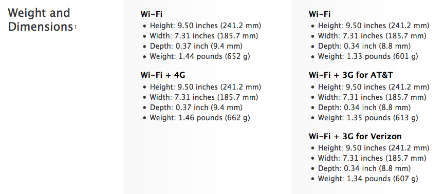

The website says the AT&T model is slightly heavier.
/bradllez
That doesn't make any sense. How would it be heavier? The main parts that give the iPad its weight are the battery, glass, and aluminum shell. The remaining parts have very little weight and the difference between one chip and another would probably require a laboratory scale.
Oh, I believe I was mistaken, it was different for the iPad 2 models.
The new iPad with 4G LTE capabilities is the same.
