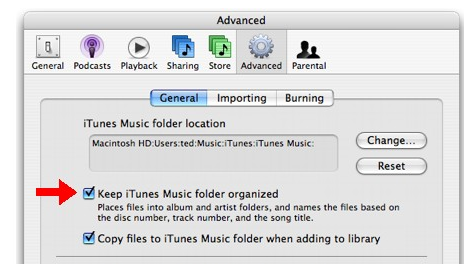

1) Make sure Copy Music to iTunes folder is checked (see Cinematographer's graphic in post #35, I think).
2) Choose a location for where you want your library in the advanced preferences.
3) Hit Ok, and go to Consolidate library under the Advanced Menu. It will ask to move all your music to the chosen location.
4) Wait patiently for music to transfer, this could take a while depending on the size of your library.
