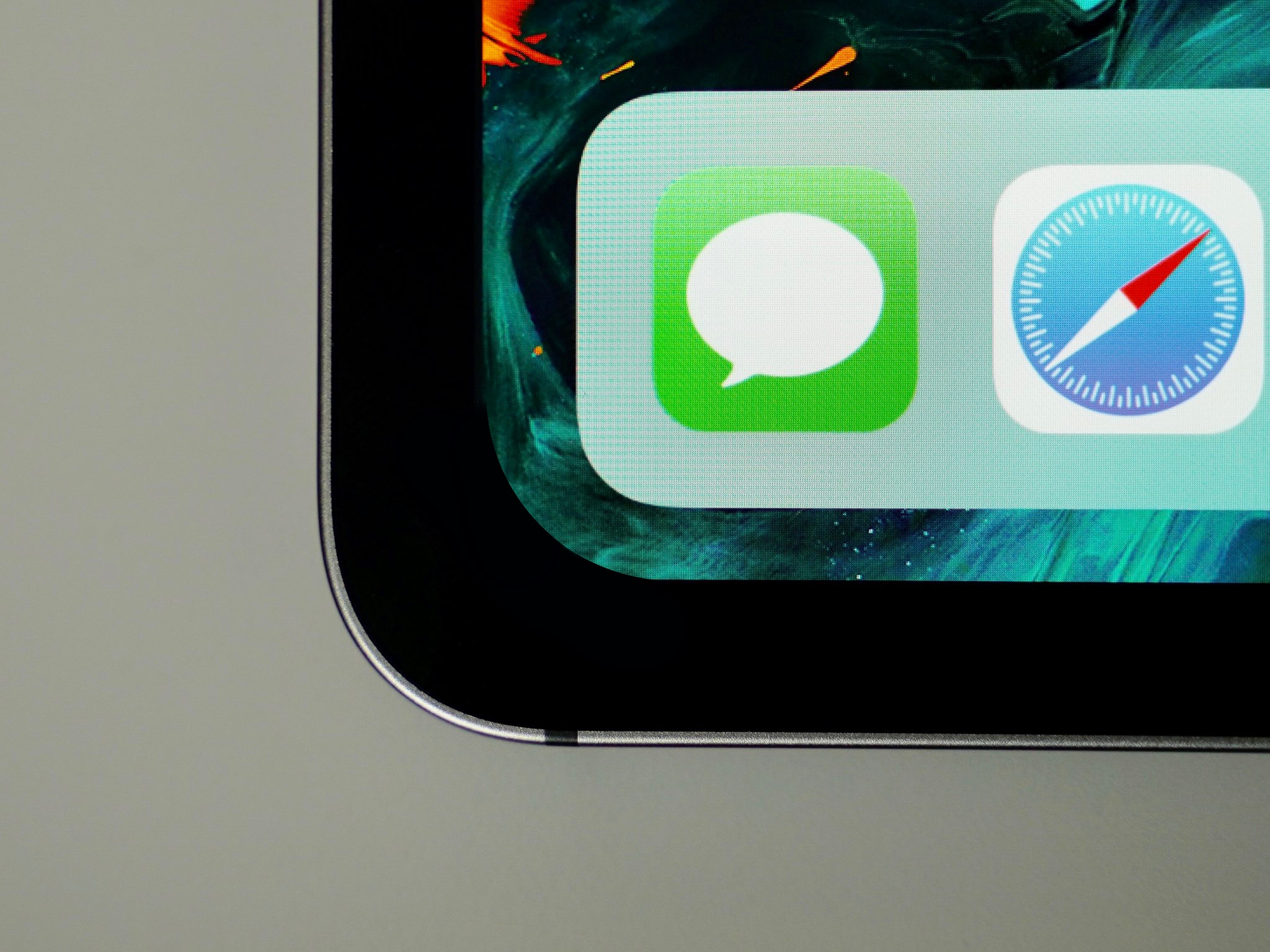

Here's an image of correct radius contour.

I’m not quite sure what you’re trying to get at. The image you posted of “correct” radii makes no sense to me. Apple’s iPad radii are appropriate, considering that the center of the arcs exist at the same point. The screen corner and the body corner are quarters of concentric circles., which makes sense and looks good.

It's obviously not the same contour and looks jarring.

Only Apple knows the reason why, but like 19SK91 mentions above, the radii shouldnt be the same. The outer radius should be = the inner radius + bezel thickness to attain an equal bezel thickness all around. I had the same question when I first started designing bent plates. Equal radii didnt look right because it made the material thickness at the bend thicker than the rest of the plate.

What are you talking about? It matches the radius correctly. The radius of the screen’s corner radius matches the iPad’s physical radius perfectly, with the same normal distance from the screen to the outer edge in every point of the curvature. It also slopes sooner to create gentle transitions with great attention to detail.
If you mean why the radius of the outer corners is not the same as the radius od the screen corners, that’s because it would look horrible if it was. Think of it as parts of two concentric circles of different sizes - of course the radius are not the same.
So, I really have no idea what you’re talking about and what you consider “correct”.

If you're asking why the screen radius doesn't match the case radius, I can tell you I asked myself the same question. Until I made this mockup with the same radius and I realized that it would look terrible.
But it's correct on the iPhone X, and it looks great. But not the new iPad Pro, which sticks out like a sore thumb.
