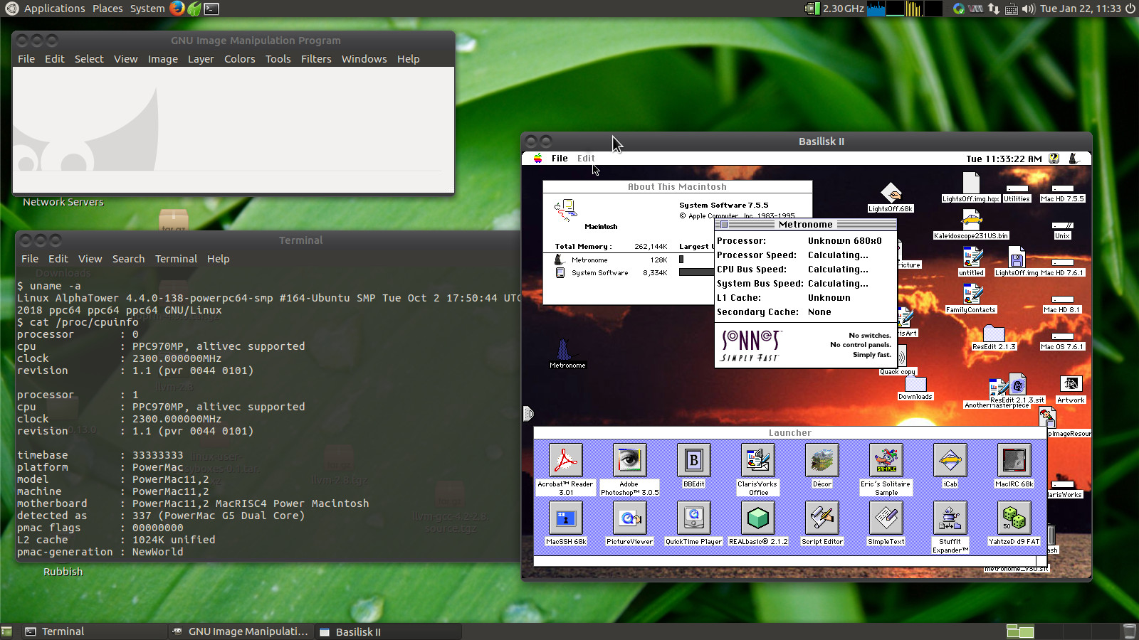

I would try running Sonnet's Metronome (v3.0) downloadable from here:
https://download.cnet.com/mac/sonnet-technologies/3260-20_4-319-2.html
I don't have any System 7.x hardware, but I was able to run the tool in BasiliskII (68k) on my G5 running Linux.
It might be able to answer the question for you @catzilla
