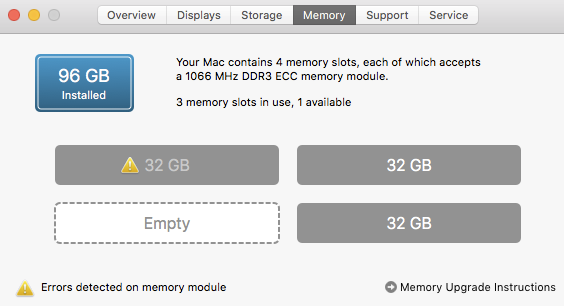

They should be reported in system report at hardware/memory if there are any. I believe I saw errors on "about this Mac" memory tab too on my 2013 when I had some bad memory, with
kisspng-warning-sign-computer-icons-clip-art-warning-icon-5b31bd67368be5.4827407215299864072234.jpg
icon besides the ram module with error.

Like this.
But only if there are errors, otherwise no indications.

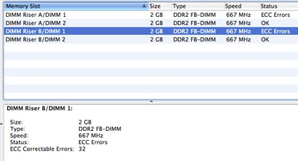

And also in System Information panels it's reported if any occur, about like this.
I don't think ecc errors are, or should be, that common. I changed the memory modules on mine, because I was getting thousands of errors per session. No crash because they seemed to be correctable errors, all of them, so the modules worked like they should. Detected and corrected the errors. But I couldn't stand the situation, and updated all dimms to new ones. Errors dissapeared almost totally. One or two times I saw a couple errors after dimm upgrade.
