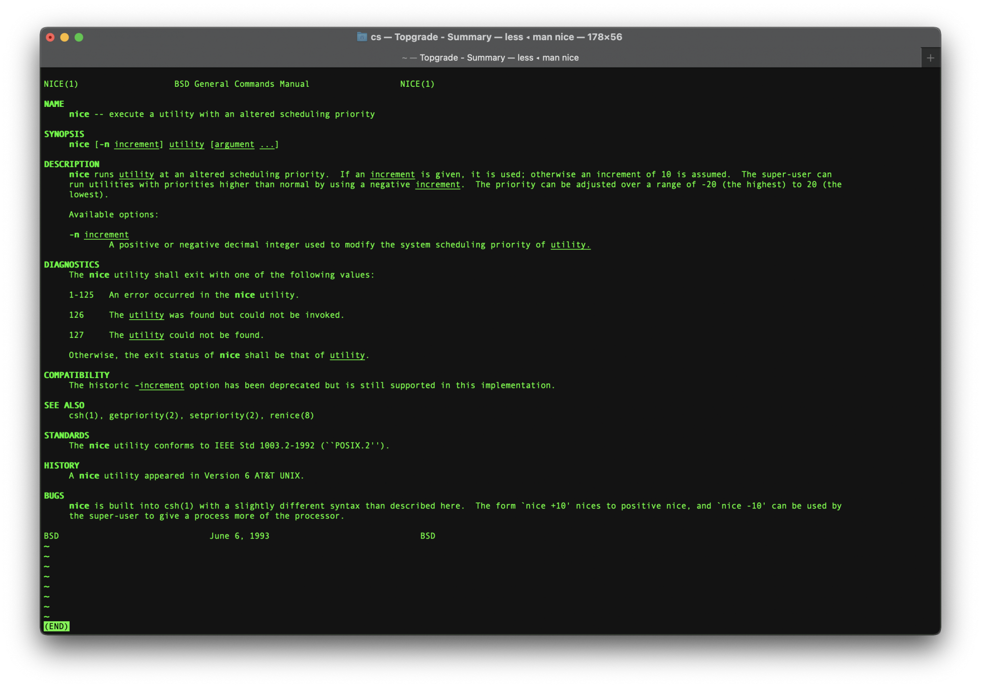

Thanks for the reply. Can you give me what I would type into the terminal for the nice command? And also, what do I do to reset everything to default after I'm done?
As always the way to use the command can be found from its manual page. To view a manual type man <command>, in this case "man nice"
So to run the Geekbench program with the lowest priority for scheduling
nice -n +20 <pathToTheGeekbenchExecutable>
mind, the executable, not the app bundle
