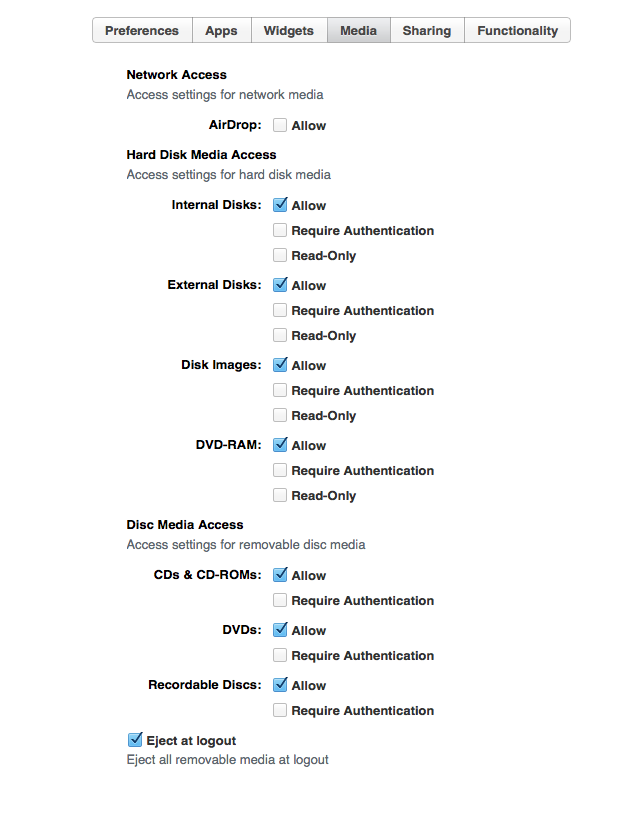

MDM Profiles can limit drive mounting, or require authentication. Not sure it would prevent the iPhone, but should prevent any external from mounting until approved/authenticated.
The challenge is generating a Profile if you don't have access to Profile Manager built into Server:
can you elaborate? unsure what you mean here.
Well, for those unfamiliar with Profiles, they are easy to use, but to be created, one needs Profile Manager (a feature of MacOS Server), or some other third party tool create a profile.
But, to the point, profiles have the option to require authentication to mount all external drives...which would remove the risk of anybody plugging an infected anything into a Mac, and have it auto-mount.
