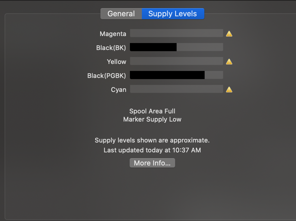

Nope not seeing it. The printer is now defaulting to red ink, despite there being plenty of black.
It would not be in the supplies panel, that just shows how much ink is available. If you can’t find how to print black and white, go to the Canon website and see if there is any documentation available. Another thing might help is to give Canon customer service a call.

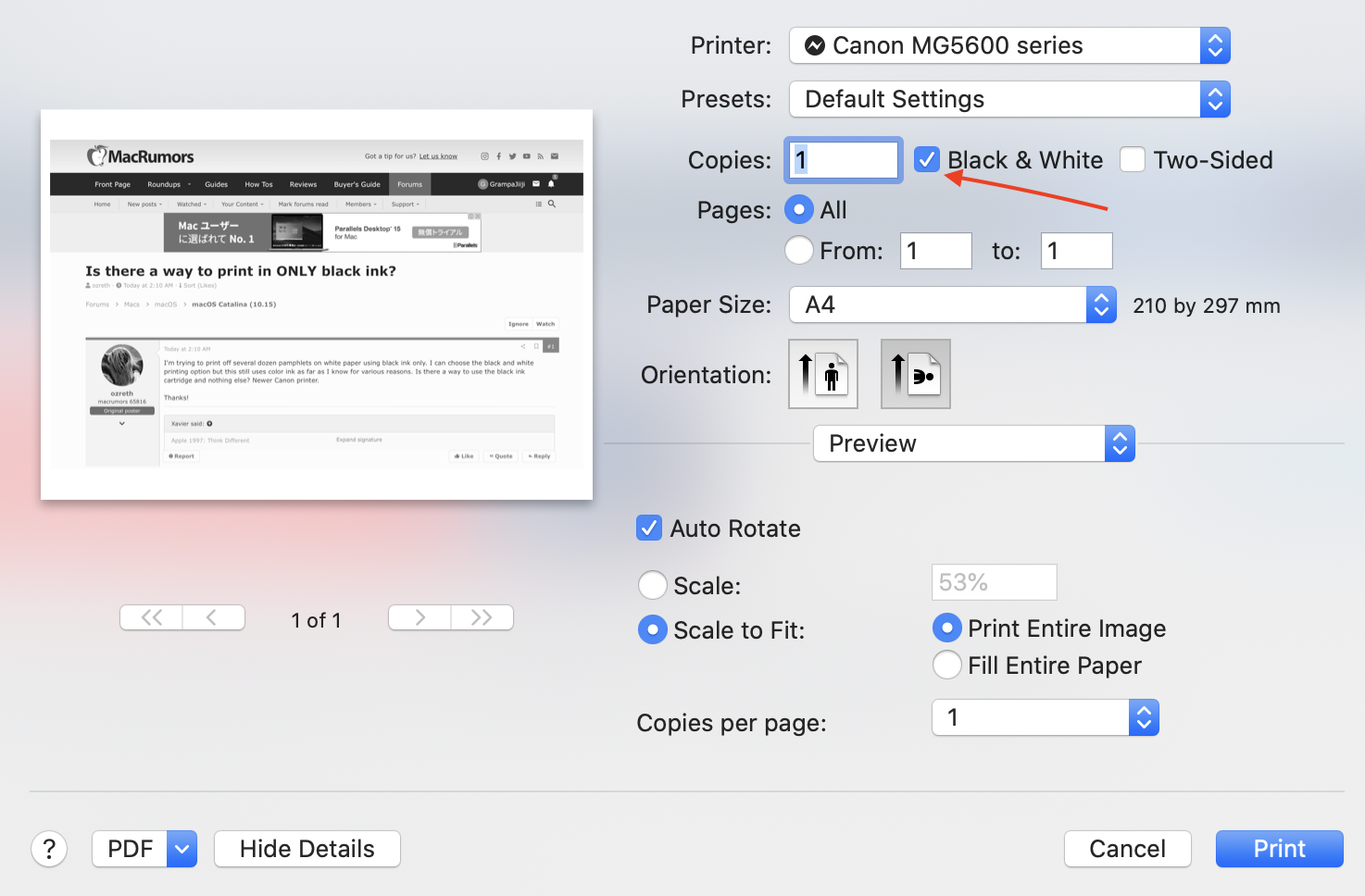

Here is an example of the printer settings for my printer. The printer settings come up at the time you are printing. My Epson printer uses grayscale for black and white printing. Other printer manufacturers use maybe a print in black and white option.
I think the OP is aware of the printer settings and how to produce greyscale or b/w output. However for many printers, when you select greyscale or b/w, the printer uses more than just the black ink. The OP wants to know how to use just black ink.
