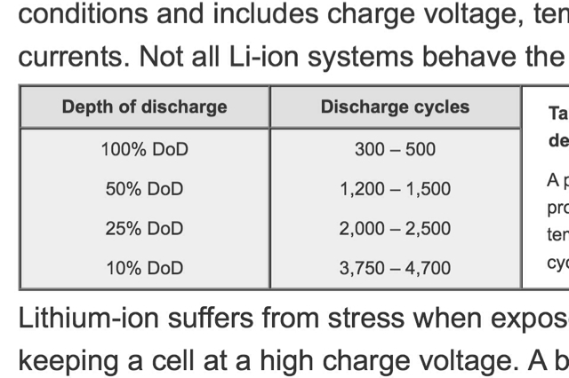

Allowing it to drain completely helps with meter calibration with battery deterioration. As recommended by Apple.
But overall it better to keep a lithium ion battery above 50% for it's longevity.
Taken from battery university dot com. A lot of interesting info on there for those interested.

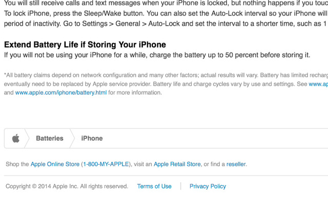

You maybe right because I can't find it on Apples page anymore however the meter (% gauge) still relies on a counter in iOS 7 diag. Only way for it to be accurate is a complete discharge. Ever have or see anyone on here say 100% to 99% last a really long time but the rest drops normally. Or the extremely common thread of phone dies at 5-15%? That just because voltage isn't lateral in it's discharge and all batteries are different.
Apple never recommended charging above 50%. That's just common knowledge of electron movement within a lith ion battery and it hardening. Check out that link, it's interesting stuff. You'll get more cycles if charged that way.
Complete discharge will damage a lith ion battery. Not 0% but 0 volts. When storing you should do that at around 50% for similar reasons. Apple still recommends that.
Pulled from Apple.com
Edit: the point of my reply is you can't have one without the other. Apple is vague for a consumer reason not that their li-ion-po batteries aren't any different then those found in any other device. There are better ways to maintain a battery, how much it helps? Well thats the question. However if there were none then Apple wouldn't say "A properly maintained battery...." on it's wedpage. It's all based on the current decade old tech. They even go as far as stating "trickle charge" which is completely false to the industry but technically not incorrect in usage.
