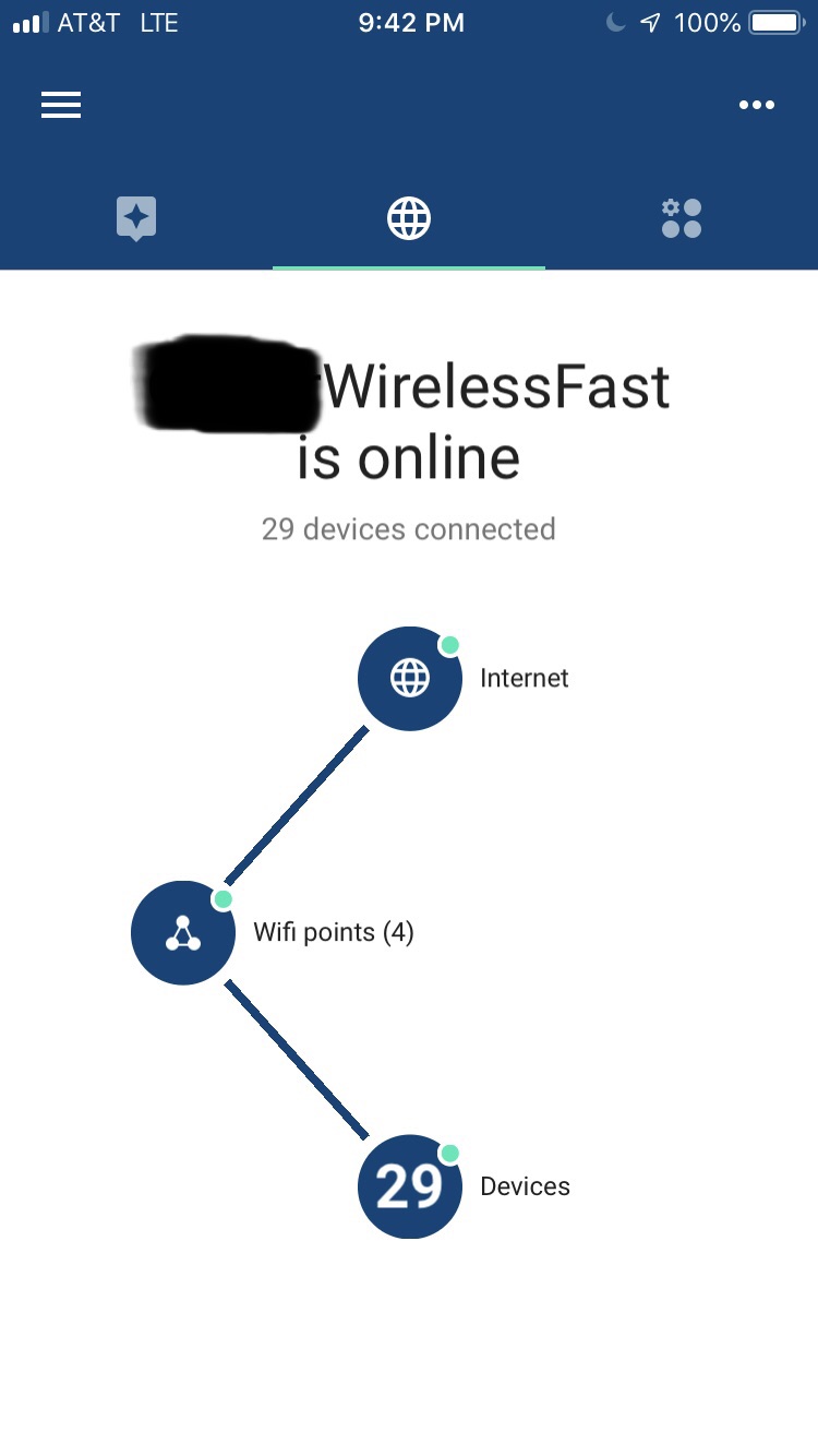

Yes, if you have google WiFi for example.
See the attached image of my network. I swear by this with our 1924 house and the plaster walls. Full WiFi signal everywhere in the house.
