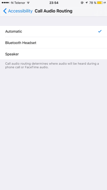

I also came across a menu in iOS:
Tell me I'm understanding this correctly. Will ticking "Bluetooth headset" route phone calls to the cars factory Bluetooth prep. Even if I have aux plugged in?
