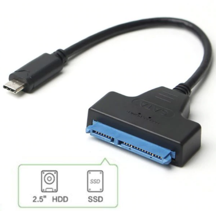

Cheapest solution is a USB-C to SATA adapter. $3.6
https://aliexpress.com/item/USB-3-1...tibel-zu-SATA-III-HDD-SSD-2/32900931683.html?
Note: TRIM over USB(-C) is not supported in macOS.
