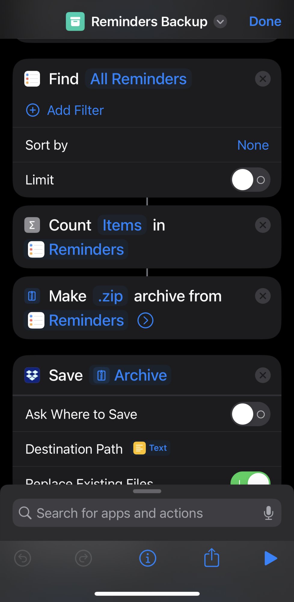

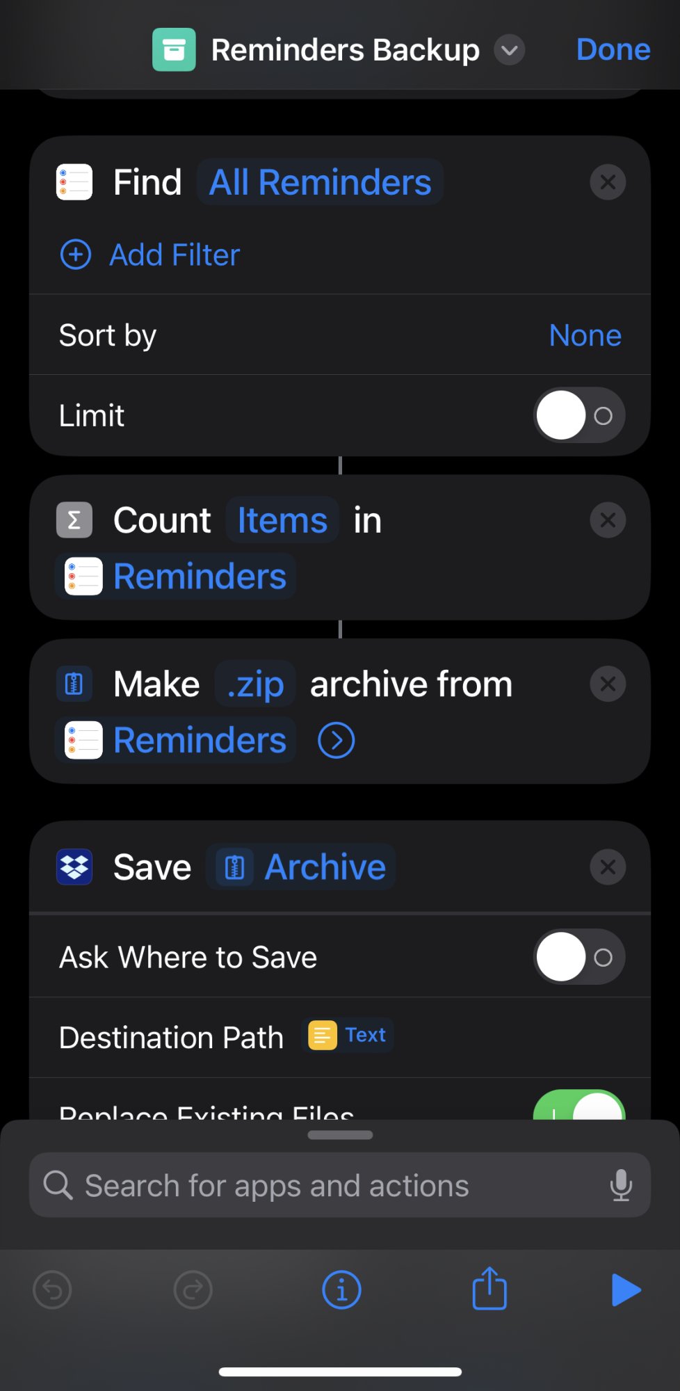

Going forward, might look into using Shortcuts to "backup" Reminders periodically. For example, as simple as attached. Or for each Reminder, save the fields into a csv file.
