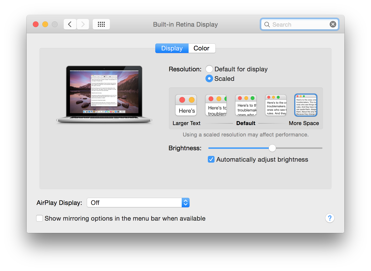

Not a developer, but i'm curious if there is still the message that is present in Yosemite about performance decreases when using scaled resolutions.
See the attached picture. This is from a 2015 15" rMBP on Yosemite. It's definitely true -- the iris pro struggles with normal system animations at scaled resolutions. The dGPU does not, but it'd be great to know if these were working better with iGPUs in Capitan.

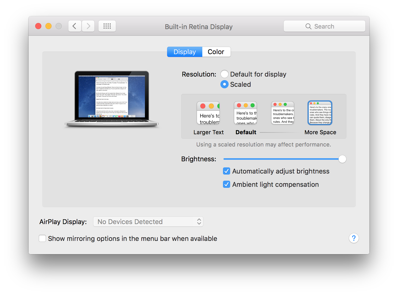

Yes, it's still there. I'm running El Capitan on a Mid 2014 13" rMBP with (only) the Intel Iris.
This really isn't the miracle update that people will have you believe. Yes it's a lot better but highest scaled resolution will still affect performance.

From swestu's screenshot I see there's a new "Ambient light compensation" option. Does anyone know what that does?
