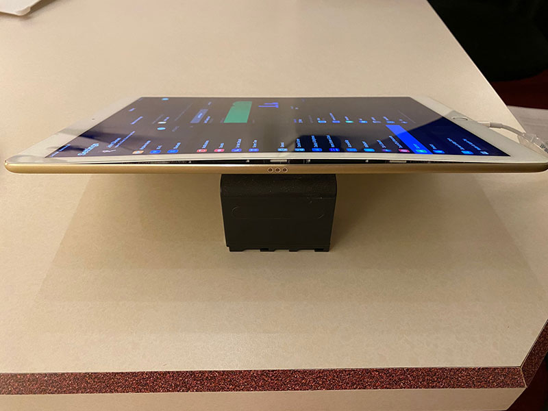

My 2015 MacBook Pro just went back to Apple because the battery started to swell up - bending the case and messing up the trackpad - otherwise the battery appeared to be working fine.

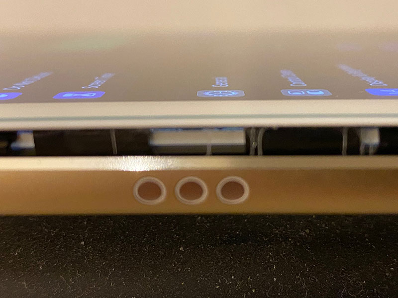

So, since my laptop is on the way to Apple to get fixed, I decided to switch over to my 2016 iPad Pro. I have always kept my iPad Pro plugged in since I bought it, but I rarely use it. I unplugged it and took it over to my recliner, opened the cover and it showed battery at 100% (as would be expected). I did some work and then noticed the battery was down to 85%, so I closed the cover and put it back on the charger. After an hour, I unplugged it to resume work and when I opened the cover it would not come on. I removed the magnetic cover completely and noticed that the screen had separated from the shell (no idea how long it has been like that or if it just happened tonight)! IT LOOKED JUST LIKE MY LAPTOP THAT I JUST SENT BACK TO APPLE TODAY FOR REPAIR WHERE ITS BATTERY EXPANDED!
Only one side of the screen has separated - I never would have noticed it had I not taken off the magnetic cover.
I then plugged the iPad back on to the charger and after about 30-seconds it came on and it showed battery was at 15%?
The iPad works fine as long as it has power.
So is this the battery? What should it cost to fix it?
See photos:

Just got off Chat Session with Apple Tech Support and showed them the photos. They said they will repair it and are sending me a return box.

Just out of curiosity, how do they separate the case from the screen to access the battery? Heat?

Yep it has to be heat to melt the glue.
Received a 'replacement" today. I guess they could not fix mine after all? Looks like they sent me an identical unit as best as I can tell. Not sure if it is a refurb or not?

Yes that is most Likely a battery issue. If you can do it yourself the battery won’t be too expensive on eBay
Apple doesn’t repair iPads. They just replace them.
