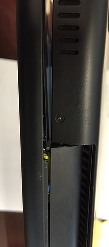

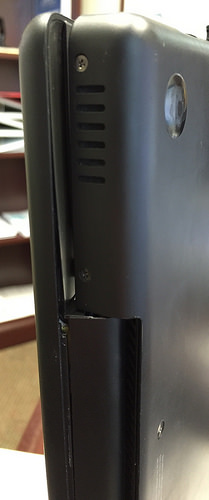

Got bad news and slammed my MacBook shut. I damaged the hinge and more perhaps. Apple store no longer has parts (if required). It still works, but when closing it does not line up right. It can be pushed and close properly. Can anyone tell from the pictures if this can be fixed? I don't mind taking apart with a little help (videos or website page). Estimate from Mac Resource is $125 evaluation fee with no idea how much more it could be. Since it's 7 yrs old, I'm not inclined to invest any more than absolutely necessary.
Just needs a hinge - a pair cost around $5 - will take maybe an hour/ 90 minutes to do
ifixit.com will have all the instructions you need.....
You'll most likely need to follow this guide, when you get to the last step, instead of removing the inverter you'll need to switch out the hinges.
It's not difficult, but there's lots of screws (most of which are different sizes), and lots of bits to remove, and the clips on the bezel can be a pain.
