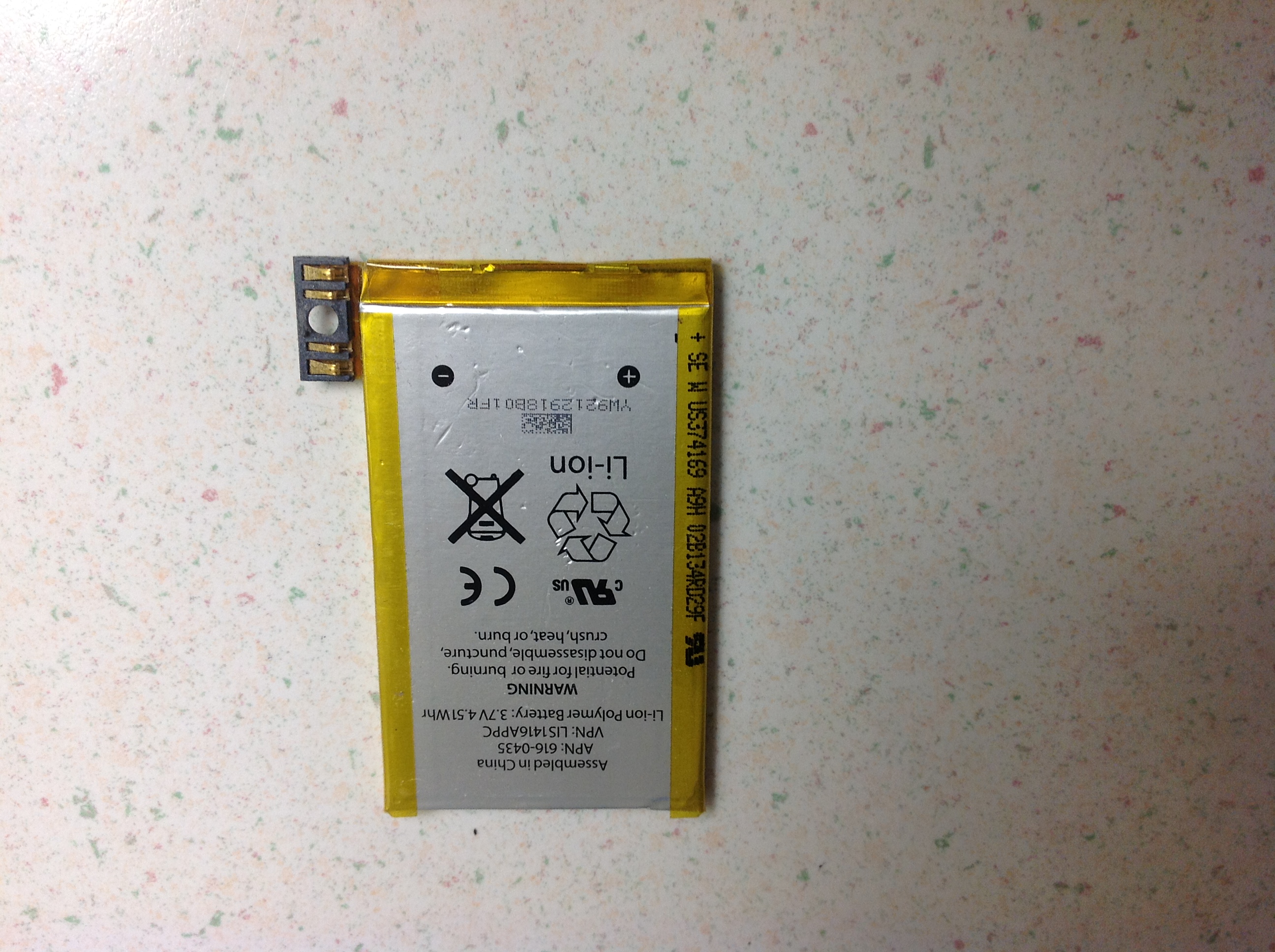

So I paid a company to replace my battery and a month later the battery life still sucks. So this time I opened it myself and this is the battery that was in it. It looks like an original based on how much it is beat up not a 1 month old replacement.
What do you think? Factory 3Gs battery or a replacement?

not original. chinese rip-off.

Not really. I was hoping it was a knock off because then he actually did replace the battery! The alternative is he said he replaced it and actually just left the same one in....
I figured he would replace it with a knock off. A brand new OEM would cost a TON.
Any other thoughts?
Any suggestions on an awesome place to buy a longer lasting battery? Now that I can easily do it myself I may want to...

Apple Certified Technician here. That is almost certainly a legitimate, OEM battery -- Apple part number and everything, all bar codes in the correct places.

Thanks Josh! So based on your opinion is this a new battery he put in a month ago or the one tht shipped with the phone? The tape residue made me think he just pulled it out to replace the other things I had him replace and then tossed it back in. Thanks!
The tape residue would suggest that it it's the original battery, since replacement batteries (both OEM and third-party) generally ship with a pre-cut strip of 3M double-sided adhesive -- clear, leaves no residue, and would still be stuck to the back of the battery or the inside of the iPhone's rear housing.

That's what I'm thinking. Another reason I pulled it apart is due to the fact that it wiggled around a little and drove me nuts. This time I put a stick of double sided tape on the back and it doesn't budge!!
I think I'll go question him on it tomorrow. My power button stopped working today and maybe I'll convinced him to fix it for nothing, I can't seem to be able to after a few hours of trying!

Can you still feel the power button click when you press it?
Yes I can feel it press. It somewhat sunk in on the left so when I pulled it apart I cleaned in out nicely and it now presses just as new but it still doesn't work!!
Do I need to replace the ribbon assembly instead of just the button?

If the button isn't working after reseating, then you'll need a new ribbon assembly. Luckily, you can find them online for under $20; try eTech Parts or Global Direct Parts.
