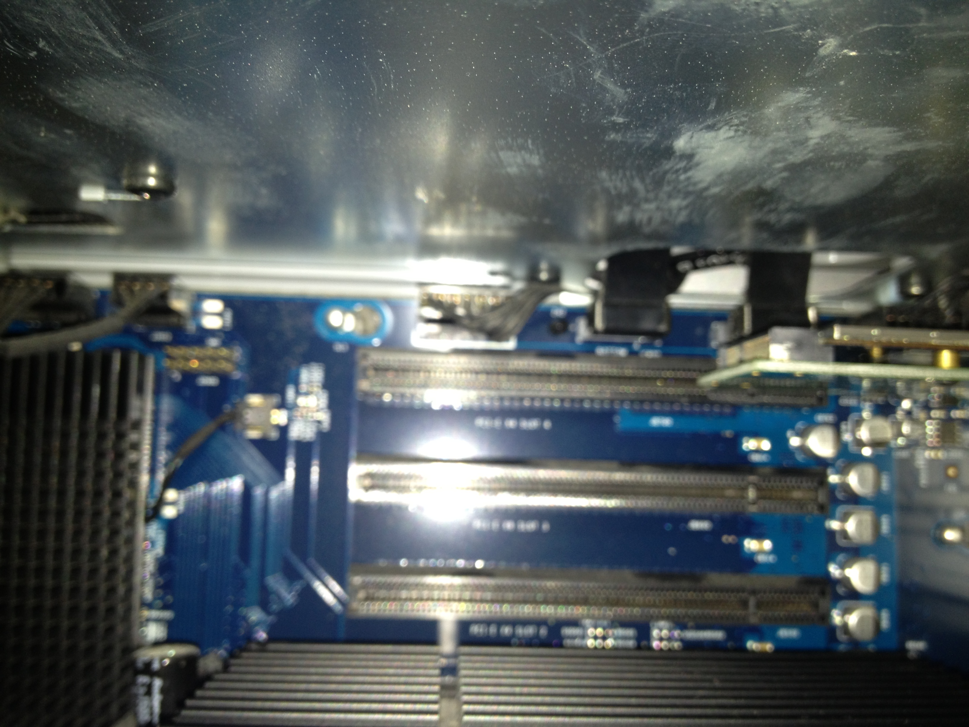

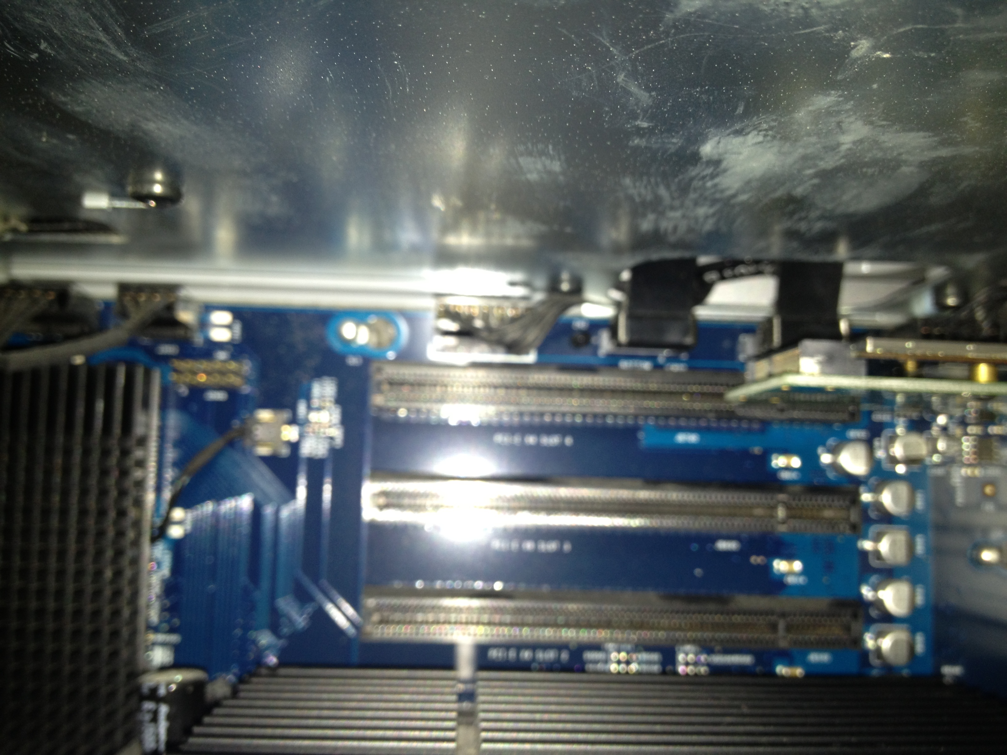

Even so, I could have sworn that all the PCI-e slots-save for the graphics slot-were the same length on the Late '05 models. Here's a "file photo" I found of mine with the Wi-Fi card installed

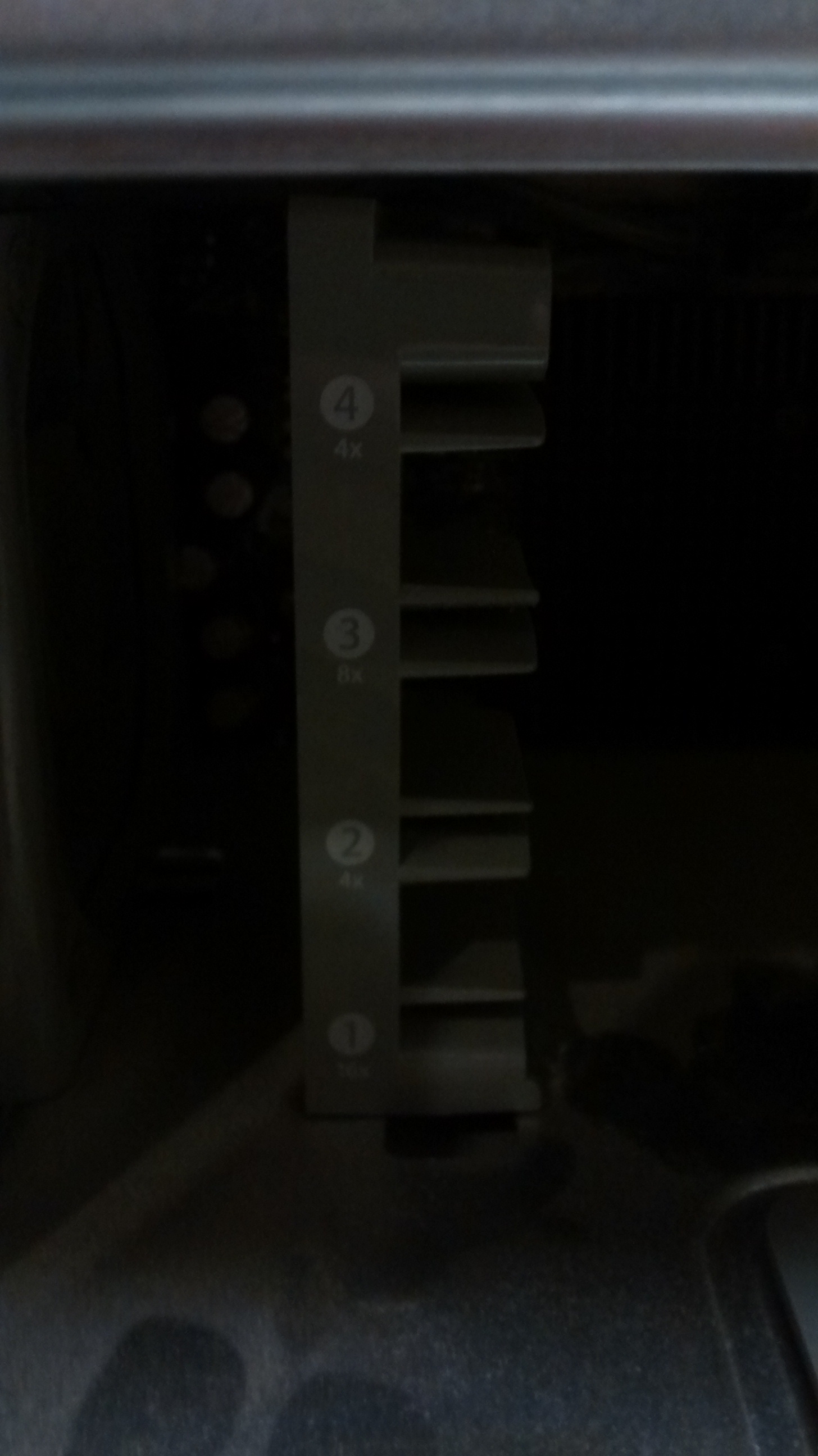

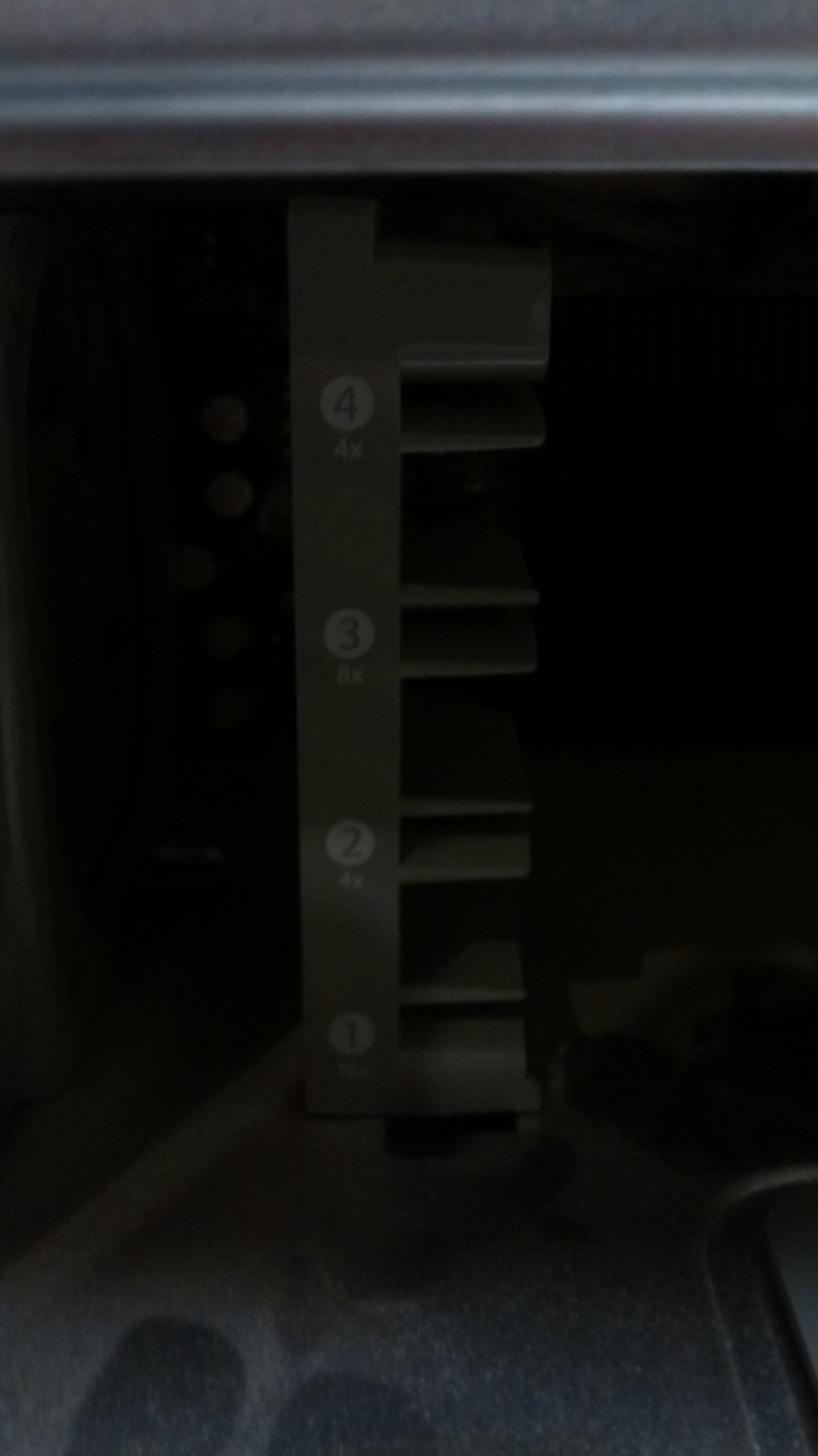

Same length, by not speed. Horrible picture, but I think it's legible.
