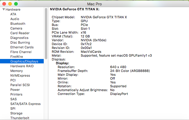

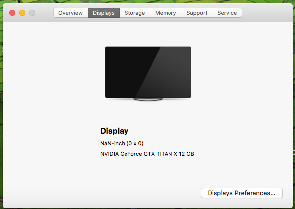

I've never had this issue before and this has just happened.
My Mac is now booting up at 640x480 and under the display profile, it is showing as 0x0. I've tried a PRAM reset, uninstalling the web driver and re-installing and nothing is fixing it. I've switched Displayports on the card with no success.
I've also booted into my 10.12.6 partition on another SSD and it is having the same display problems too on that OS.
Does anyone know... Is this a sign that my GPU is starting to go bye-bye? I'm running on a DCI 4K monitor, so this is looking horrible at the moment.

I only have this GPU. It is an MVC flashed card.
I am using the latest web drivers. I've switched between the web drivers and the native driver and am having the issue regardless.
SIP is enabled. And the PSU is fine. The computer is running fine otherwise... its just suddenly as if the 4K GPU output just disappeared. I'm a bit at a loss as to what to do.
Was running in 4K 10-bit using SwitchResX. Reverted to standard profiles. Still having the issue.
What's strange is when I reboot on my other 10.12.6 OS volume (which is using a different web driver version) it is having the same display issues now too. Which is leading me to think it's a hardware issue.

I just tried the HDMI output on the card and it works at full res (at 24Hz)! But all the Displayports are acting the same way with this issue. So now I got to see if this is a cable issue or are there issues with the displayports? I'm hoping this is just a cable issue! Especially if it is happening on all the 3 ports. I won't know till tomorrow when I can get my hands on another chord :(
[doublepost=1520733728][/doublepost]Just found a spare Displayport cable and tried it on all the ports. Having the same issue. So the HDMI works fine, but all 3 displayports are showing this problem. You think the flash mod would have anything to do with this? It's odd that its showing on all Displayports now.

Thank you guys! I tried turning off the monitor overnight and still had the issue this morning.
BUT then I did what you guys just mentioned and unplugged it for like 30 minutes, then tried again and now it is working!!!
I've never seen his issue before where unplugging it fixes. That's strange, but I'm not complaining.
