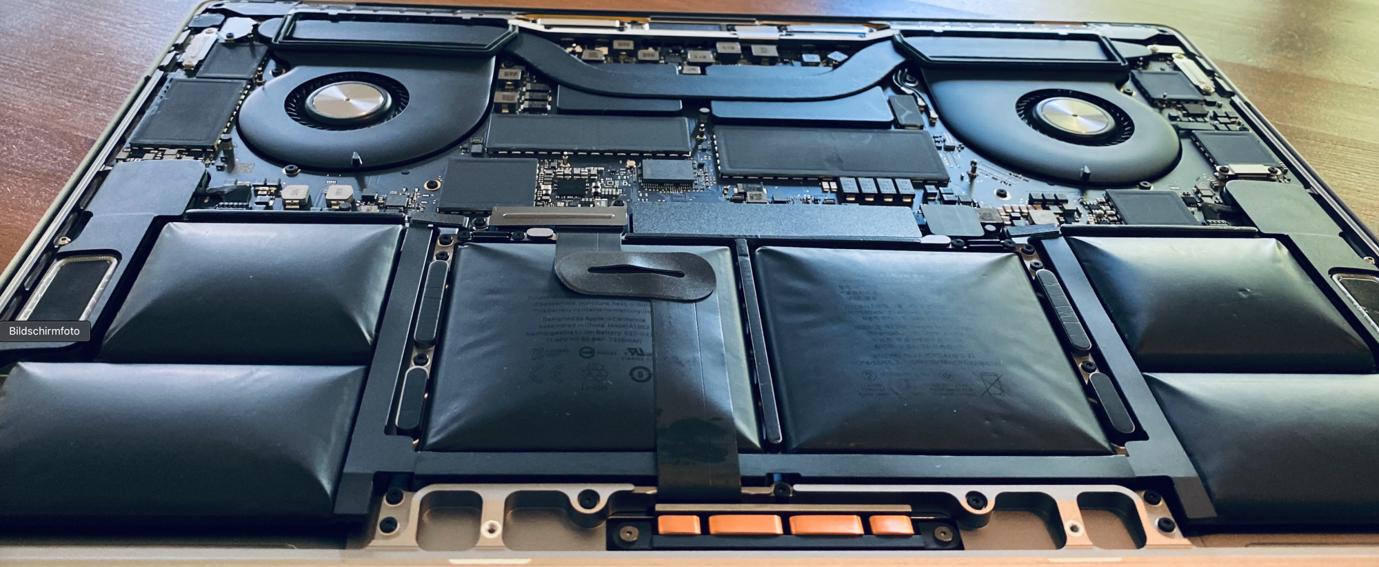

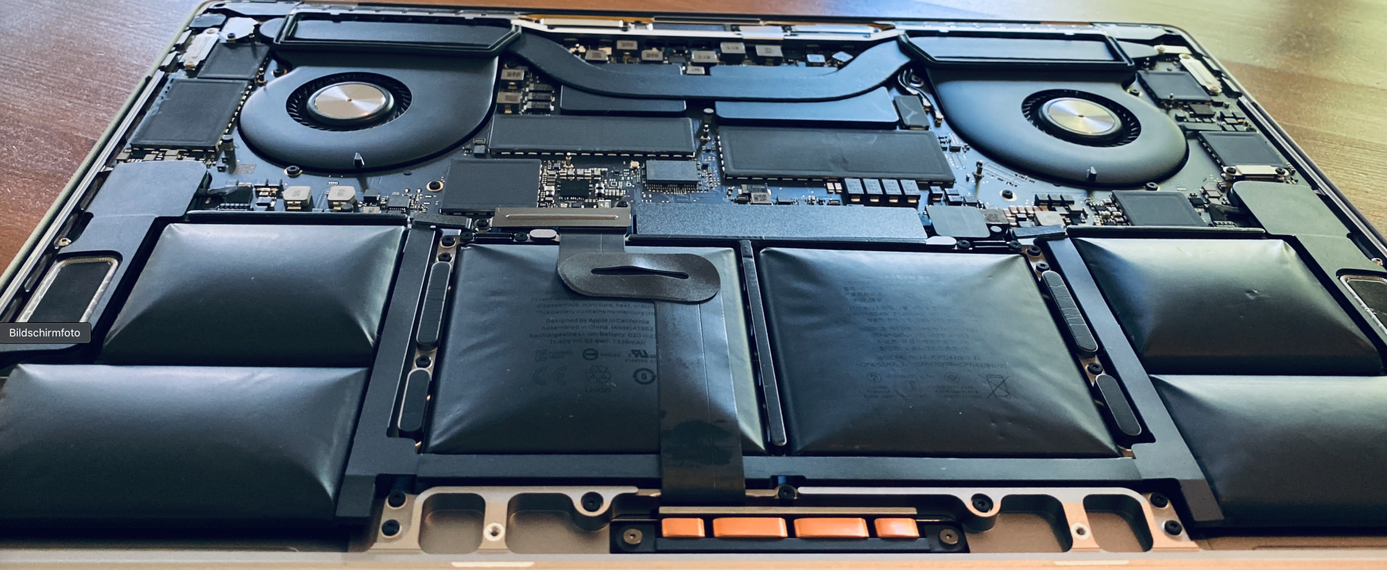

MacBook Pro 2018 (July) 15" i9 -- yesterday, I will bring it to an authorized repair center tomorrow. BTW 36 cycles, condition good ...
radus wrote (with pic):
"MacBook Pro 2018 (July) 15" i9 -- yesterday, I will bring it to an authorized repair center tomorrow. BTW 36 cycles"
Just wondering...
Are you one who kept the MBP "plugged in with the charger" almost all the time?
And... almost never took it OFF the charger?
If the answer is yes... I reckon that had a lot to do with the battery swelling up.
  • Haha
Reactions: 1226670
Just wondering...

Well brought the Macbook pro to an Apple Repair Center.
They could not repair it and they did not take it because sending to an other Repair Center is "to dangerous".
The Apple Service - Phone Advisor suggested an other Center with a time slot on thursday.
Good night for people depending on one Apple product by profession ... .
