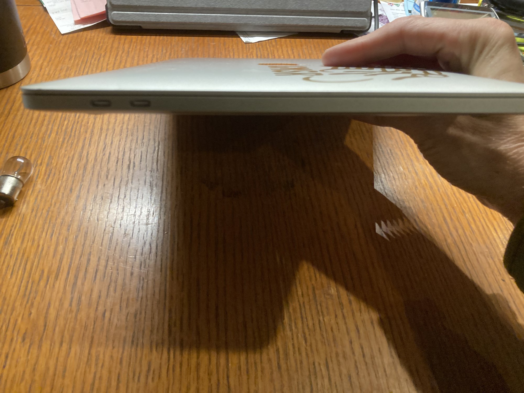

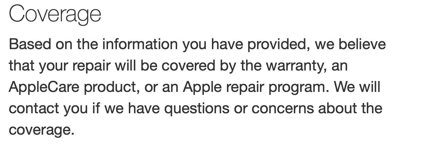

I did contact Apple via Chat this evening. I was not sure what to expect after yesterday's disappointing conversation. The rep was helpful and typed "Oh my" when she reviewed the photos I send which are the same as the ones posted above. They are sending me a shipping box and she told me a typical battery replacement would be $199. When I received an email confirmation it included the following: View attachment 961617
I am hoping that they will repair this defect for free. I will update the thread once I know. I am planning to wipe my laptop before sending it. I also see I could use FireVault but I have not used that perviously. Does anyone have recommendations on what would be best and easiest. I back-up via Time Machine to an Airport Time Capsule, as well as a stand alone 2 mirrored disk NAS drive and will also add a separate non-networked SSD drive as well (can't be too careful!). I would expect some password and other glitches reinstalling from a TM back-up but not sure. Glad to hear member's thoughts.

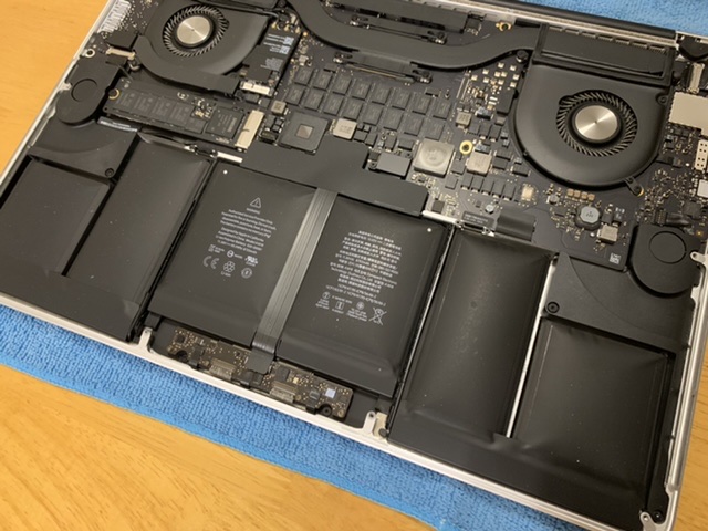

I noticed that my laptop wobbles on the table. First thought that the table is deformed. But the laptop wobbles on other tables too. I took out the bottom. The bottom cover actually sits flat on the same table. This is how the battery looks like. Is this considered a swollen battery?
The model is mid 2015 MBP with Retina display. I bought it in May 2018 so it is out of warranty. Checked series number and Not part of the recall. Battery has 55 cycles and battery life is normal.

Thank you to everyone who chimed in with advice in response to my posting. I received my repaired laptop back from the certified Apple repair center yesterday and I am just getting it back working. The paperwork says they replaced the top case and battery (not sure what that included). So far so good. All at no charge. I suspect the photos I posted which I sent to the Apple rep on the chat were sufficiently scary that a free repair was in order. Very appreciative for the good service. Too bad it took speaking to several Apple reps to get this resolved. My after picture:

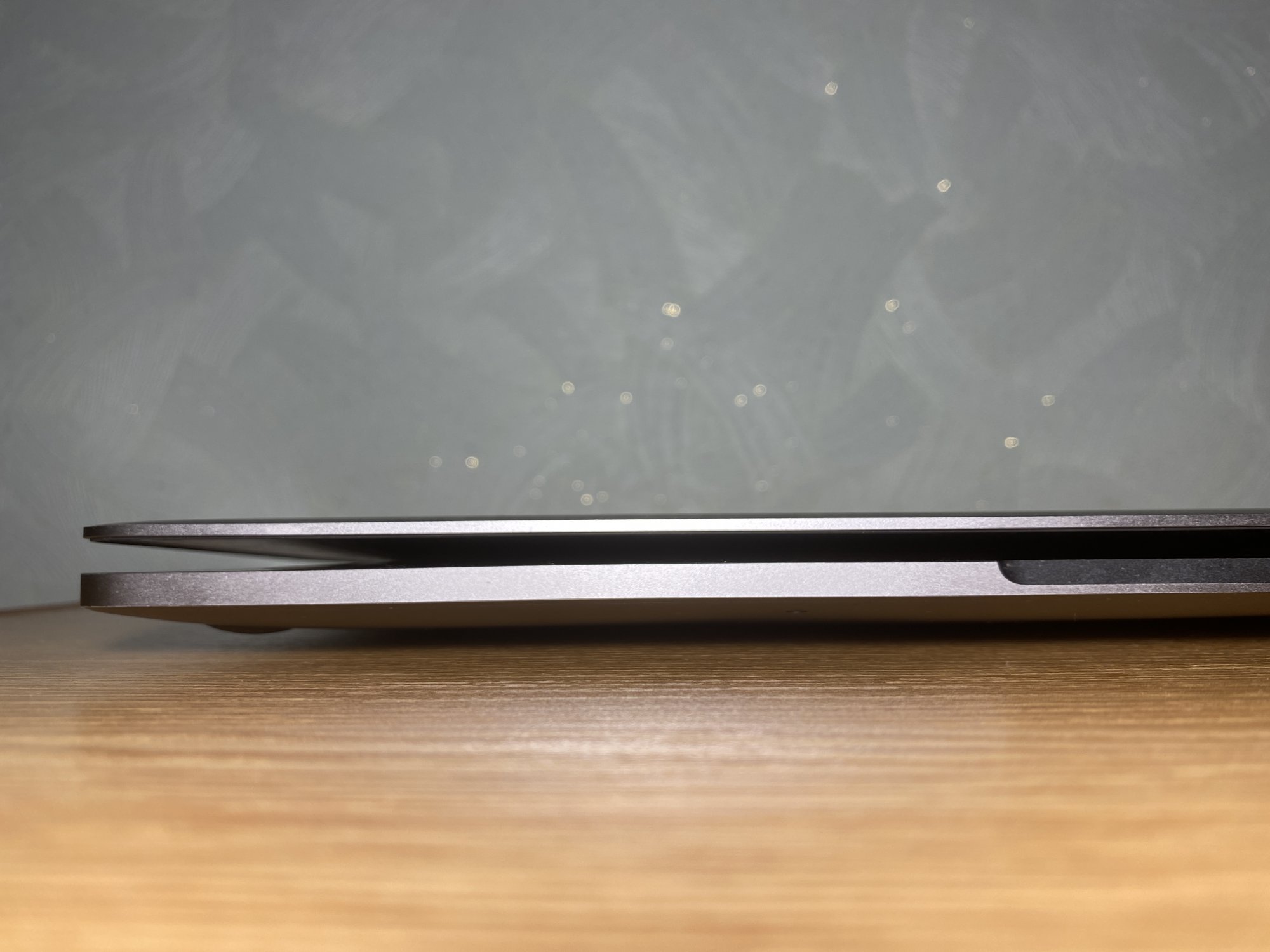

I have the same issue with MacBook Pro (15-inch, 2018). It is not sitting flat and the lid is not closing properly.
Is it possible to run the Apple Service program for this case? How many customer complaints should happen and where to complain about it (I don't live in the US)?

Yes, you do have a swollen battery (of course!), and I reckon that Apple will still offer a free replacement on a 2018 model.
If you have an Apple Store nearby, make an appt and take it to them.
If you DO NOT HAVE an Apple Store near, call Apple directly.
DO NOT call a "3rd party service provider".
CALL APPLE.
They may send you a prepaid shipping box in which to return it to them.
EVEN IF APPLE WANTS YOU TO PAY for a replacement, it's still a good deal.
In the USA this costs $199 which includes parts, labor and a short warranty.
But... don't delay on this.
Call as soon as you can.
