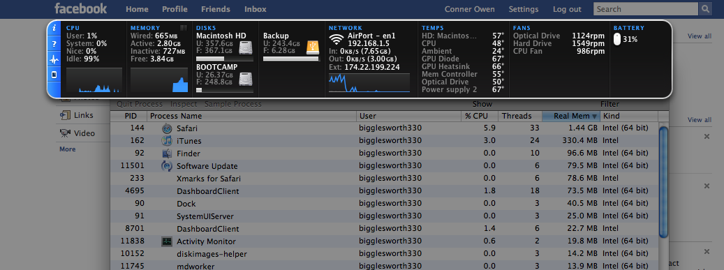

It's a hard issue to show, because it happens seemingly randomly. I attached some screenshots at the bottom of this post to show how much the fans will run. This happens completely randomly and doesn't seem to be tied to any program. Does this, my very slight yellow screen, and the slowness warrant a replacement?

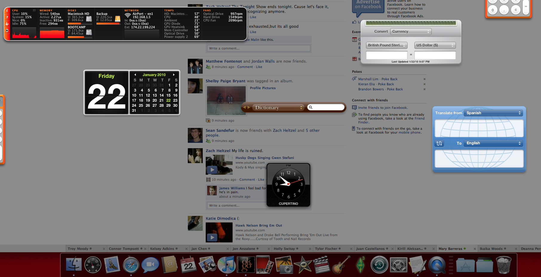

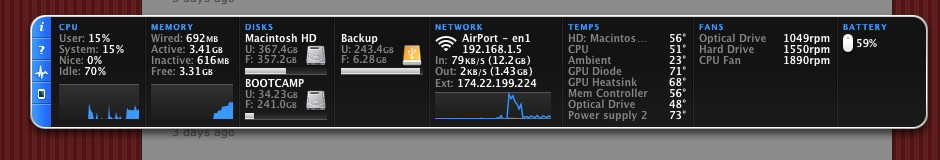

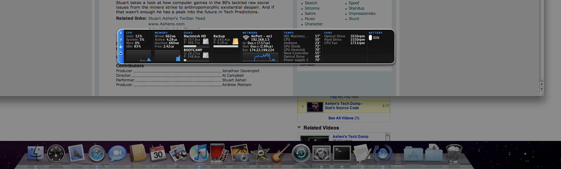

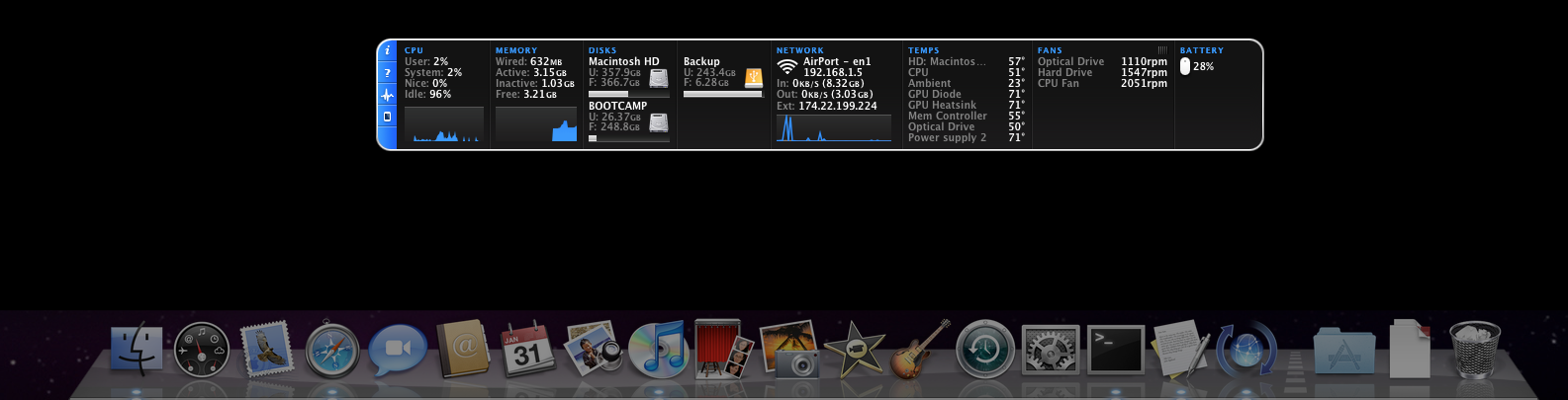

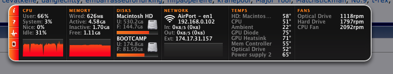

Ugh... reinstalled SL a few days ago, and as I'm typing this all three fans are running at ~1300 RPM. All I have running is Safari and iTunes! Why does it keep doing this? It doesn't affect performance, but the fans are annoying. I just got a 21.5" iMac at work, and it's amazing how quiet it is compared to my 27". The 21.5" doesn't get very hot even after a day's use of Final Cut and After Effects, whereas my 27" is scalding hot after barely any use (Safari/iTunes)! Why is this happening?

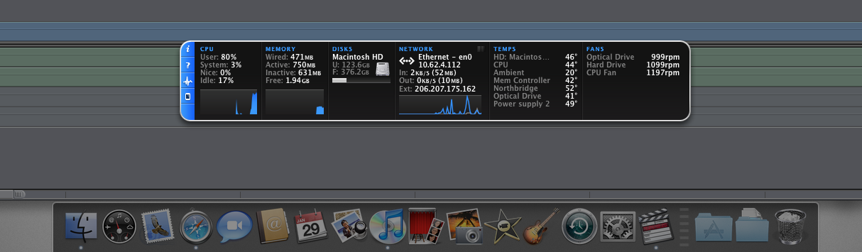

Here's some new screenshots. The screenshot showing Final Cut Pro running and has the 2D dock is my 21.5" iMac at work... at the time of the screenshot it was rendering a huge video with iTunes and Safari running at the same time, and yet the fan speeds/temps are substantially lower than my 27" iMac doing nothing. Both computers have fresh installs of 10.6.2. The screenshot showing the activity monitor shows the fans aren't incredibly high, but it's just running iTunes and Safari. The 21.5" iMac gets the same fan speeds while rendering a large video. If I tried that on my 27" they would easily get up to 2000 RPM.

I'm surprised no one has pointed out the high CPU usage in your 27", much higher than your 21.5". Something is running, but you don't have iStat showing the processes.
I've got an i7 and when it is doing nothing the CPU is basically at 0% and you can't hear the fans. It takes running handbrake (which utilizes all cores for a long period of time) to get the fans to get somewhat noisy, but even then I wouldn't call it objectionable (It's the quietest of four iMacs in the house).
That's what I thought... My 24" iMac made absolutely no noise. What should I do about this? I can hear it running like my old Windows PC when it's idle. I have to play loud music over it to not hear it.
As I said, your CPU usage is high. List the processes. Something is really hogging your system.

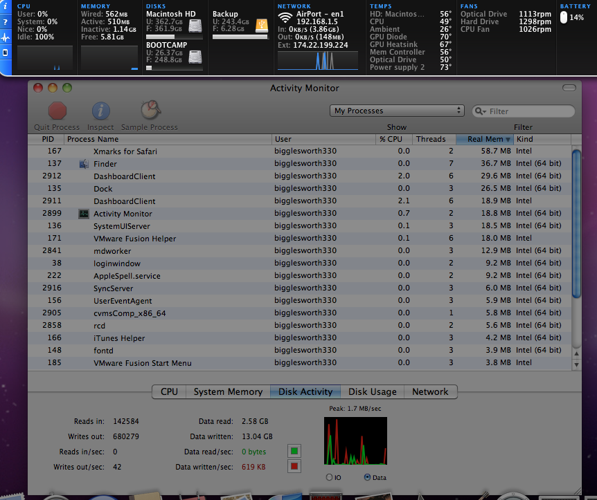

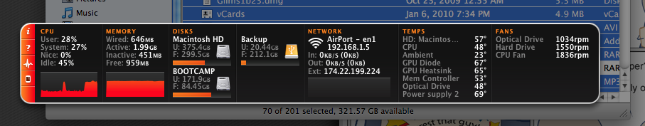

Sorry this took so long to get, I've been compiling stats over a week. Attached are screenshots showing temp, fan speed, and what processes are running. The fans speed up at really random times, when nothing is running. Compare this to my 21.5" iMac running FCP, Safari, iTunes, Adium, VMWare Fusion, and iMovie (Importing videos from camera) with absolutely no noise and you can see there's a problem.

Yeah your fan speeds are a little high for sure. My fan speeds on my 27" are 1000, 1100, 940 in that order in iStat. Always. Unless I'm doing something super intensive..
Maybe reset the SMC?
