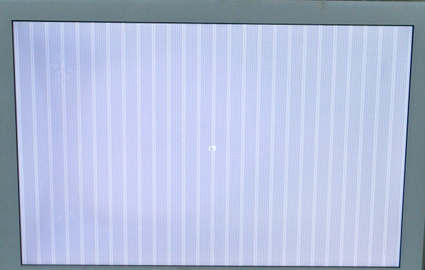

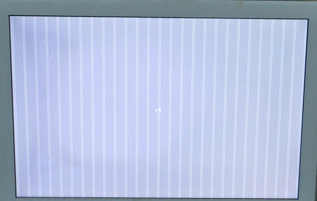

I found this dirt cheap iMac G5 on the web someone is selling nearby, but it has the vertical lines problem.
The screen looks like this:
Would this machine be salvageable or should I just leave it?
What could possibly the issue be?
it might just be the display - in that case you could plug it into an external monitor if you bought it. on the other hand the graphics card may be faulty, in which case it's game over unless you have FireWire to use target disk on it.
It may be the LCD, I would pick it up because you could use an external monitor or replace the LCD. Either way there are parts there that can be used
Target disk will just make it a big clunky external hard drive.
Due to the strange pattern on the screen, I suppose it's the graphics card tho, and not the LCD
Repairing the graphics card might cost me more than the machine is worth because I don't have the right tools for it.

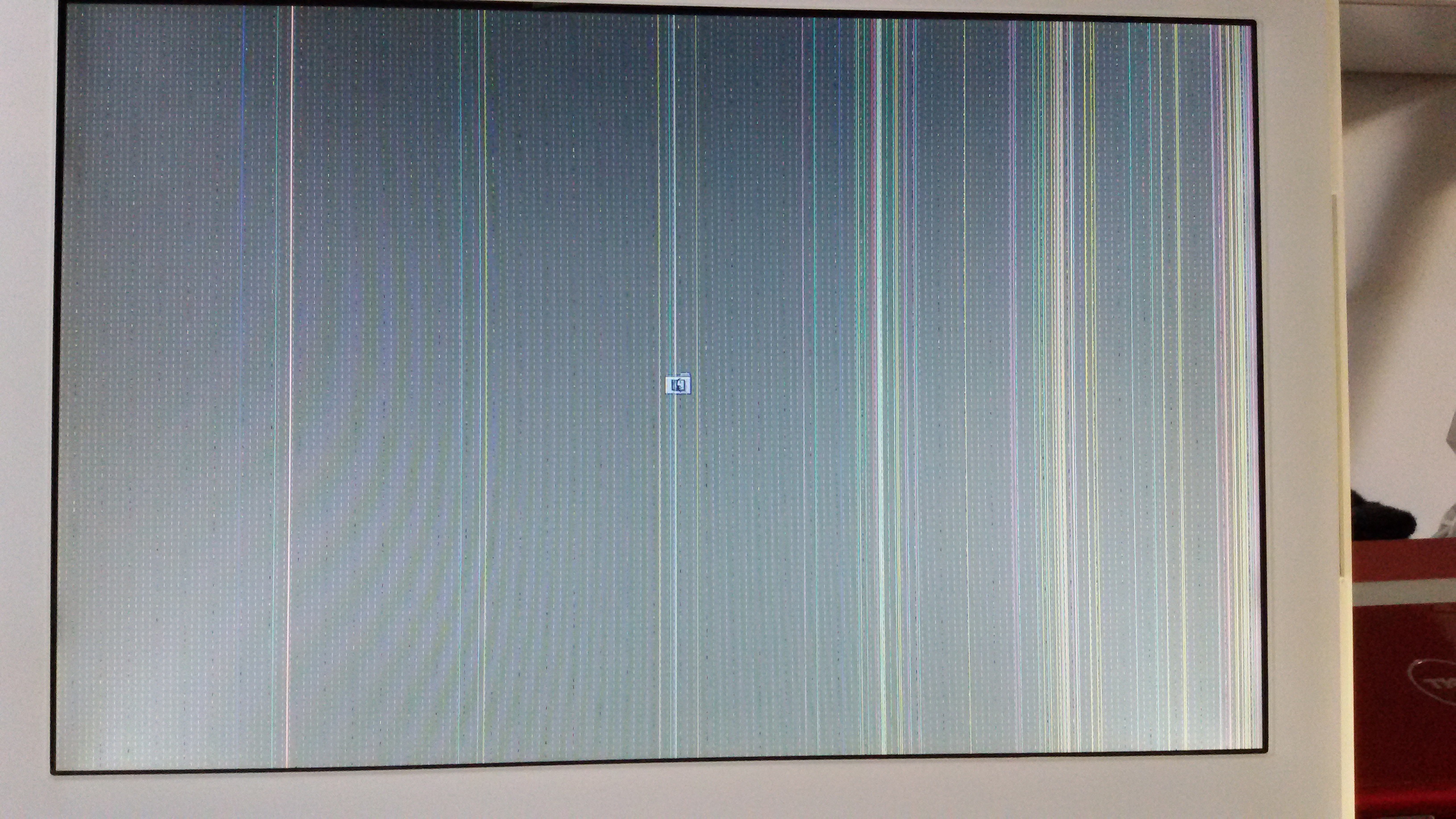

Vertical lines suggests it's more likely the panel to me, especially if they're consistently in the same locations. A bad GPU/VRAM would be more random. It's a risk.

PKBeam give me an idea. You could try to start it in target disk mode. If you see a FireWire symbol bouncing around on the screen, that would indicate GPU is bad, if not, then the screen is bad.
The machine shows the finder icon, because it does not have an operating system installed.
You can see it in the picture
