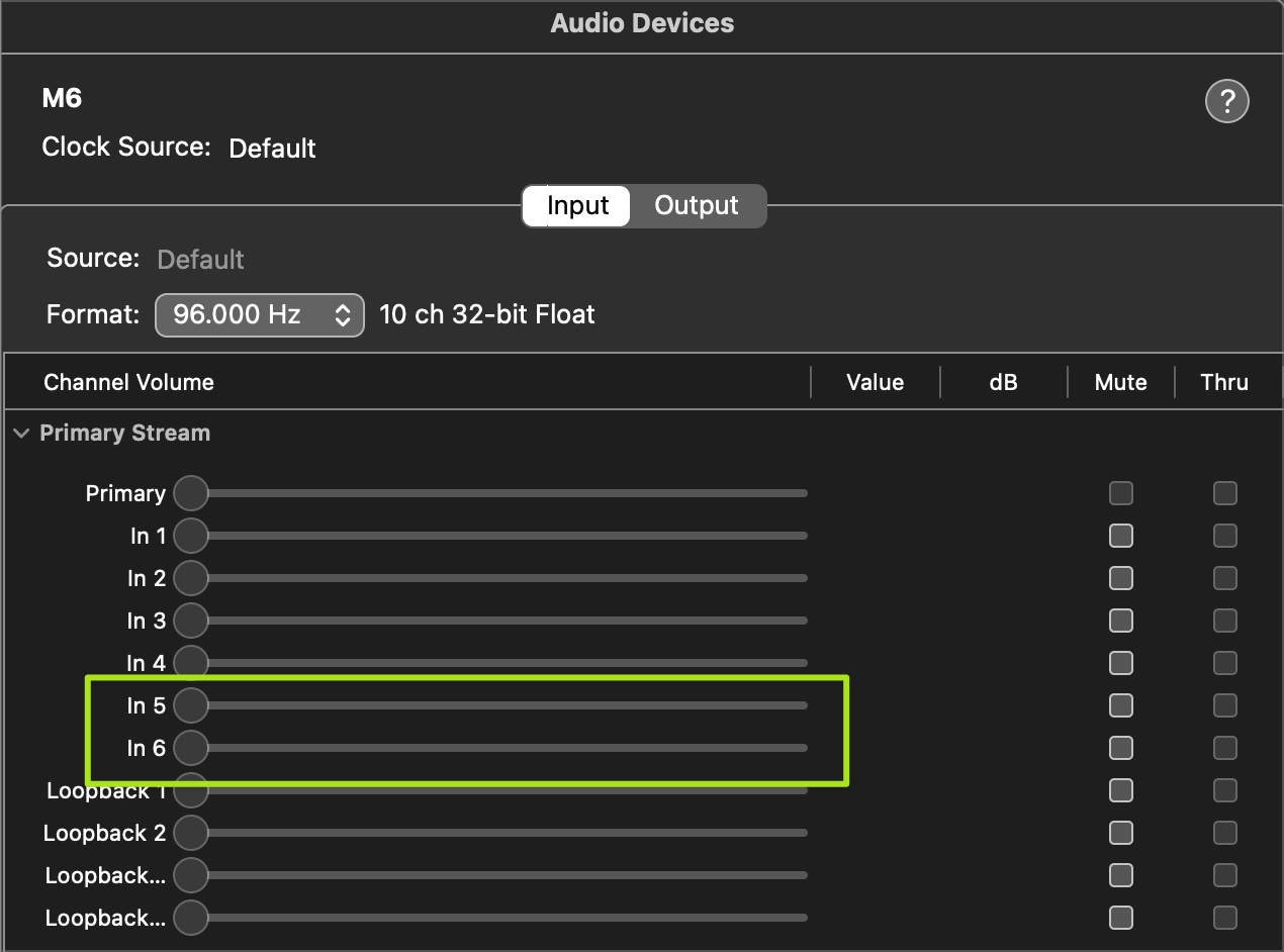

I am using an external USB audio interface (MOTU) with my Macbook M1 Pro.

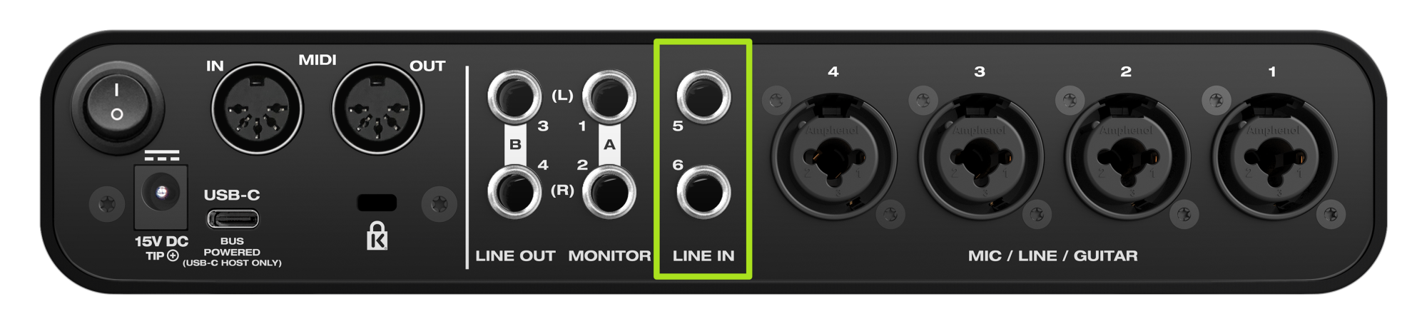

The MOTU has two LINE IN jacks (called In 5 and In 6 in Audio Devices).

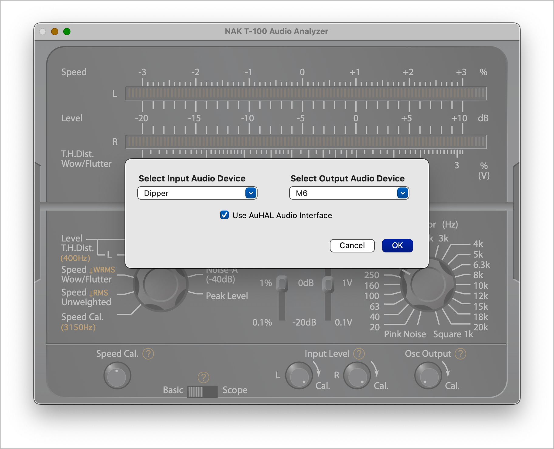

I am using an audio analyzer application called NAK T-100, which will only listen to In 1 and In 2 from the system.
I want the app NAK T-100 to receive input from the MOTU LINE IN 5 and 6 (system In 5 and In 6).
The MOTU does not have any routing software.
Is there a system setting in Sonoma or a routing software which will make this possible, i.e. take the signals arriving on MOTU LINE IN 5 and 6, and route them internally to system In 1 and 2?

I checked on the analyser app you mentioned, NAK t100, and point #10 in the bottom notes on the page seems to indicate that you need outside routing.
Reactions: kitKAC and IngoX
Yes, outside of the NAK T-100 application. Not outside of the computer. Just making it clear for everyone.
Although the NAK T-100 app can select which audio device to use, the settings of that audio device have to be configured outside of this app by using system provided tools.

The macOS does not hear input 5-6 on the MOTU as of now. And I don't know how and if I can make the macOS hear it.

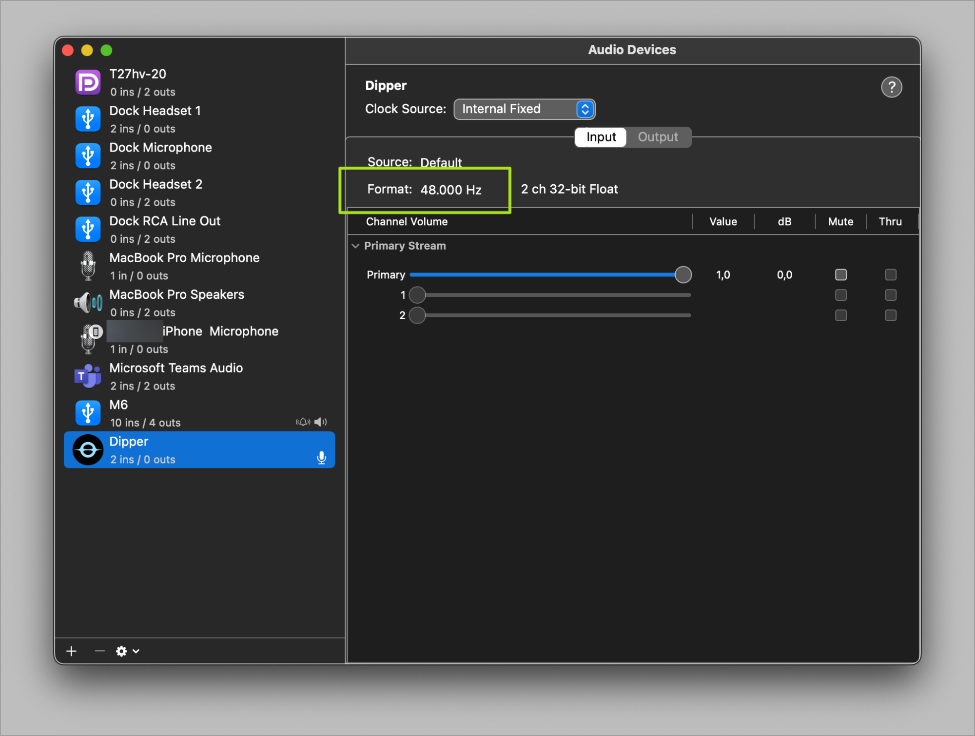

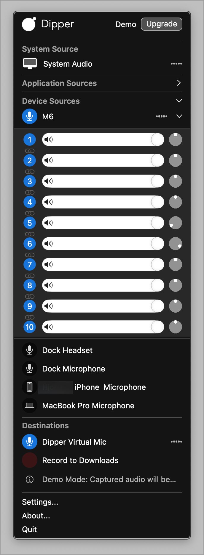

Ok, I'm trying Dipper but can't get it to work. It seems that an extra app is needed (DipperVirtualMic.pkg), but I can't install that here. It gives an error from the system.
I have Dipper working now! Most of the time. I think it is quite buggy on my macOS (latest Sonoma).
The only issue I have: The only way I can listen back to the signal arriving at MOTU input 5-6, is to hit the MONITOR button directly on the MOTU, which is just a thru function (hw routing input 5-6 directly to output).
But this issue is not crucial. I need to experiment some more, but many thanks for helping out.

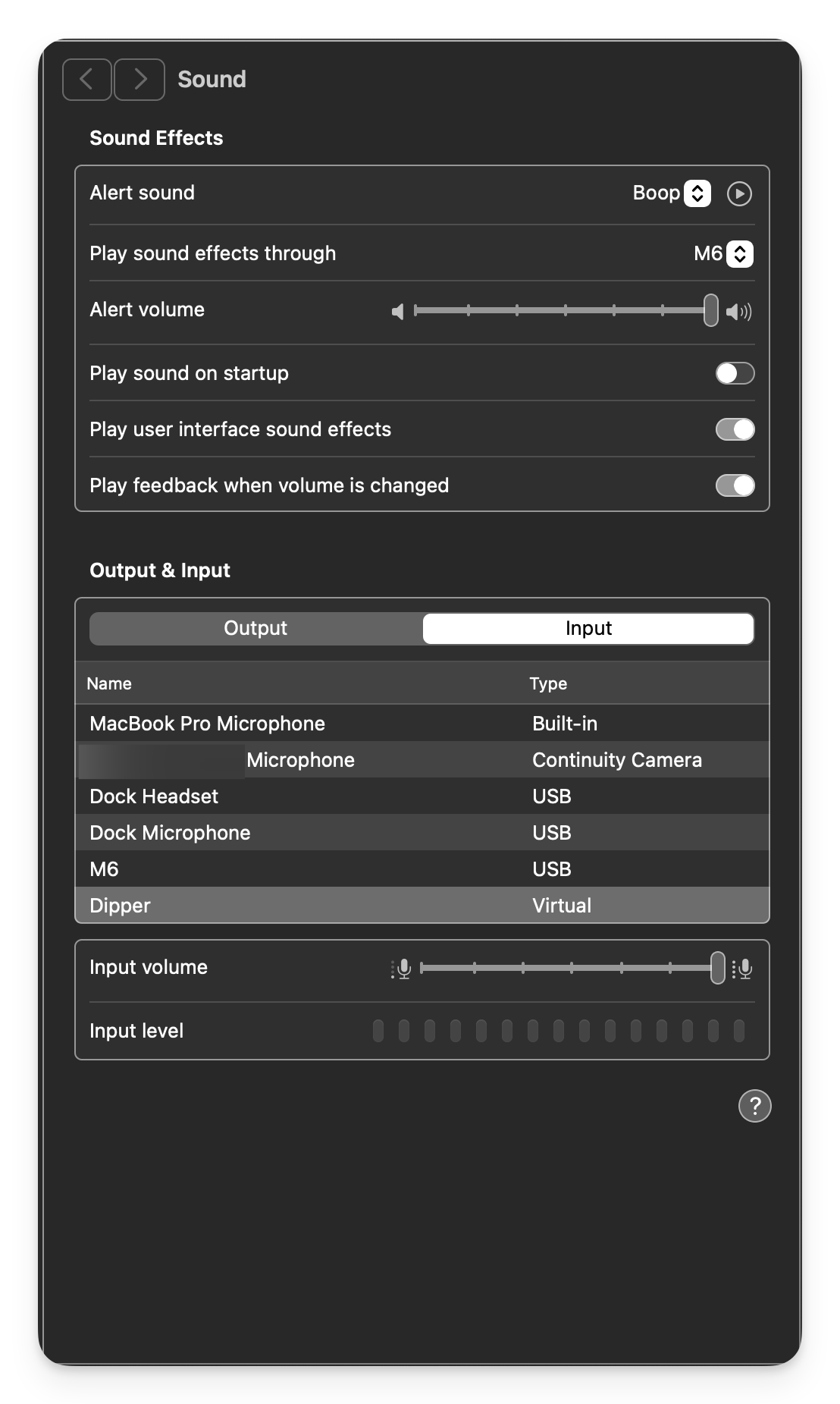

Perhaps these pics can document how I got it to work if you're interested :)
Dipper
macOS
NAK T-100
Reactions: sahnert

Unfortunately, Dipper only supports 48 kHz sample rate. NAT T-100 recommends 96 kHz for best measuring accuracy.
The fact that dipper works in general makes me wonder if you could get Blackhole to work through the system audio settings, as it does support 96k according to the website.

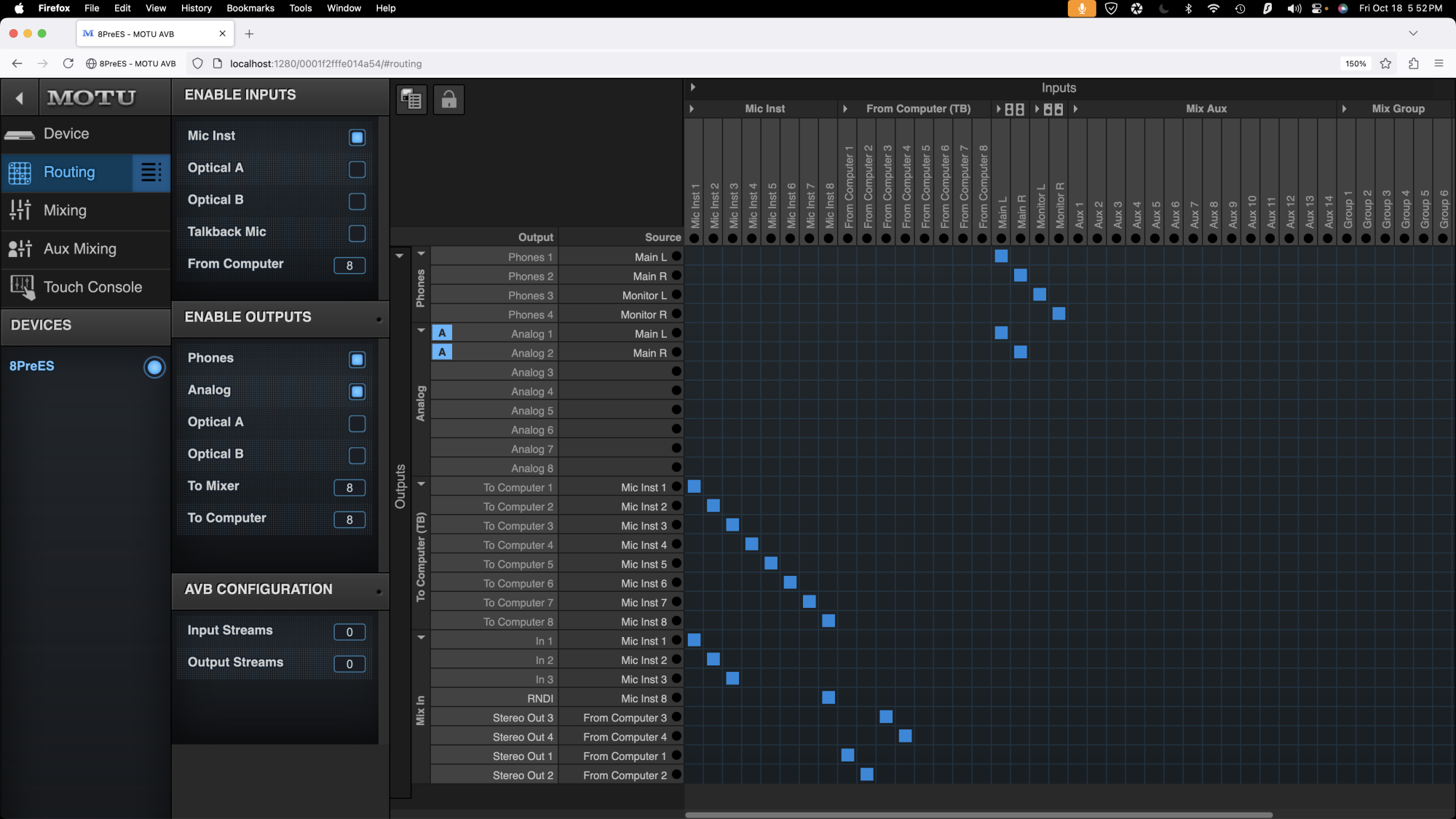

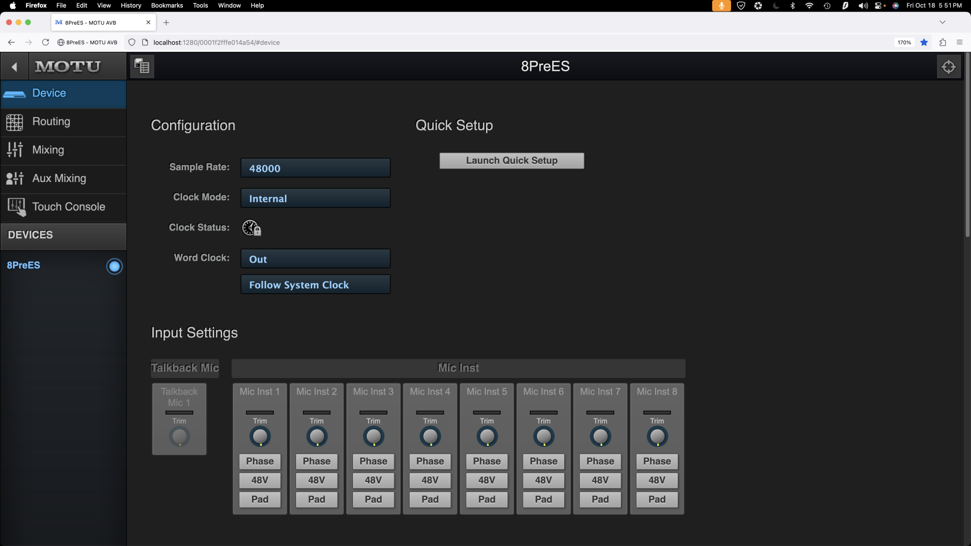

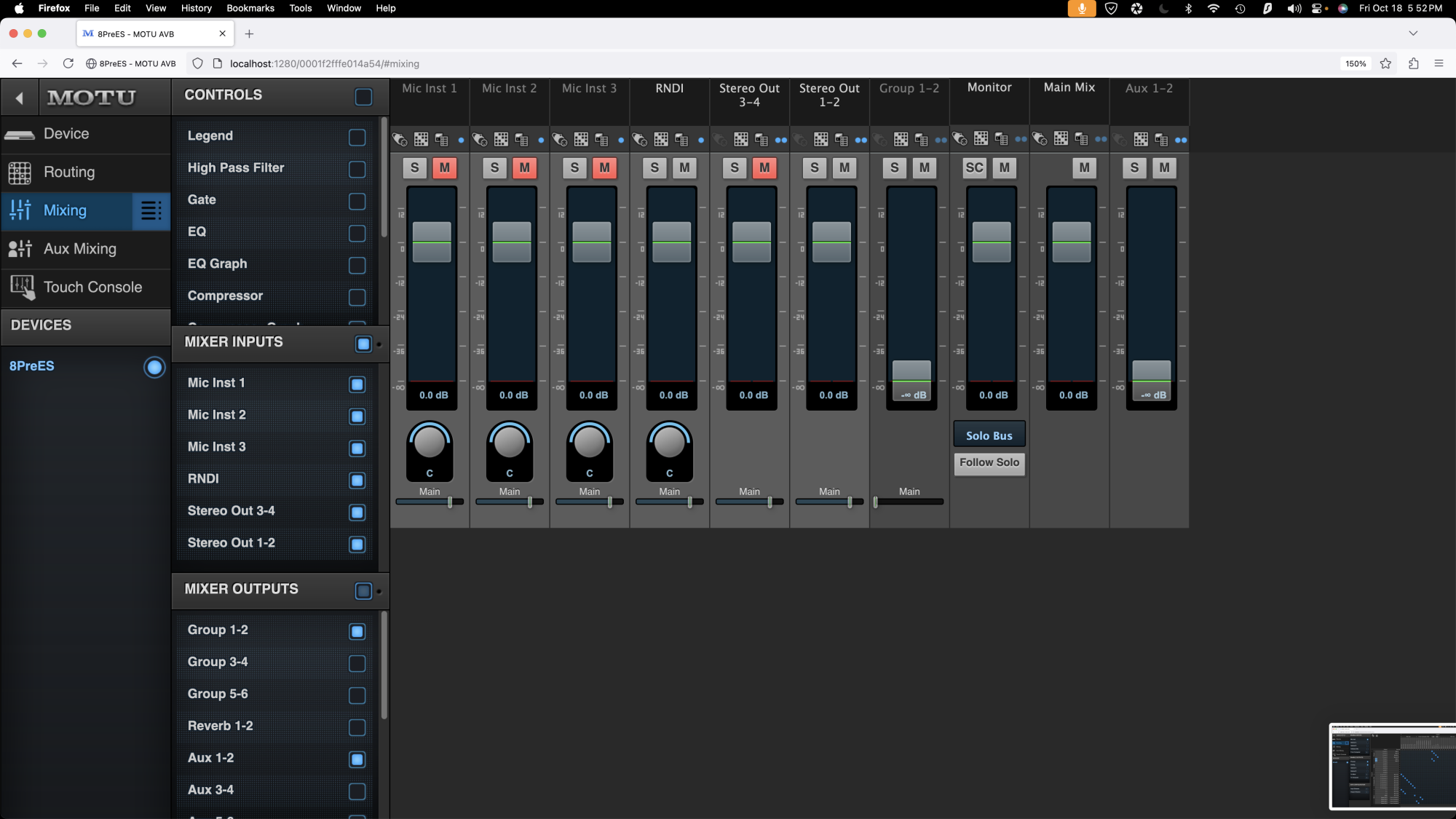

hey @hjorte doesnt the MOTU M6 support the use of their "browser-based" setup (MOTU AVB)?
Im using the 8pre-ES and I control the hardware setup (Routing/mixing/ext device like iPad/ etc) via my browser. I thought all the 'new ' MOTU interfaces used the same system control? It might be the best solution if the M6 utilizes the same (2nd image is the routing setup)...
PS> check with the MOTU.com Knowledge board the support staff are great with accurate (and quick) answers👍
No, I'm pretty sure the M6 does not support the AVB network function. I think it would have to have a networking port to be able to do that, which it hasn't.
