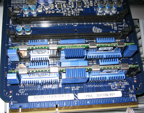

I'm running two of the Kingston 1GB modules, but I placed heatsinks all over them. No problems so far. **knock on wood**
I bought four sets of these:
NewEgg
They came applied with tape, so nothing more was needed. I just attached them to the heat spreader.
Assuming that the RAM processors are doing the same amount of work; then the hotter heatsink means its more effective at removing heat from the RAM module than the one cooler to the touch.
That samsung has a heatspreader, not a heatsink.
