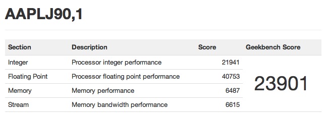

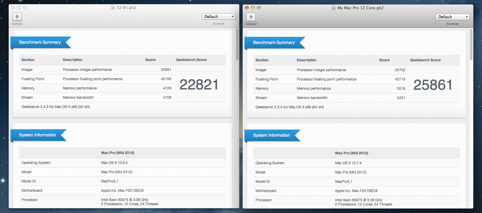

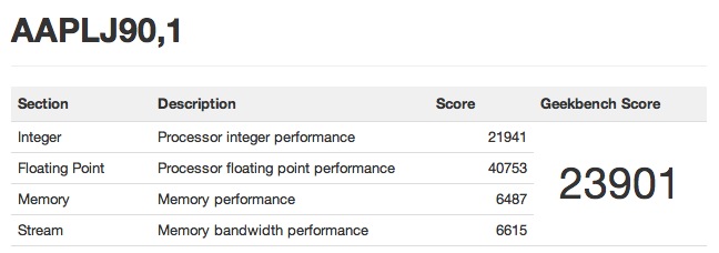

Not to drive this off topic, but I suspect you made a good choice there. It sounds like it allows you to complete work, and realistically you could wait out revision 1. I really suspect that with the 2 gpu thing, they wouldn't go that route unless they were expecting higher GPGPU prevalence, but that takes time. By the time all of your software is really aligned with the new machine, it might be past mid-cycle. That is assuming the outlook for it is actually good. I hate the number of chipset features that it doesn't use more than anything. You could get 6 drives on the SATA bus and just back up to a DAS solution.
Yes, I was really disappointed by the small speed bump on 2012, and lack of USB3, T/B, but I had to buy then, because the 2008 was just not cutting it anymore. I plan to upgrade the GPU to the GTX680, and add a PCIe SSD. That should keep me going a few more years. The 3.06 12 core was a big jump in render time over the 2008. About 2.5 times faster! After seeing these first Benchmarks for the New Mac Pro, I think I made the right choice. Here are my benchmarks compared to the new Pro. Not bad for the previous model. After seeing those marks, I went out and bought AppleCare.
