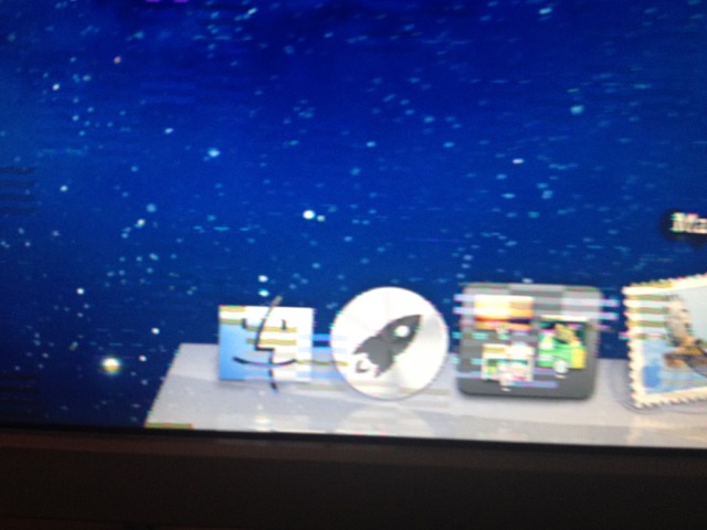

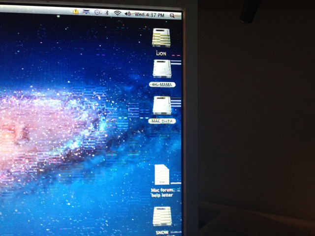

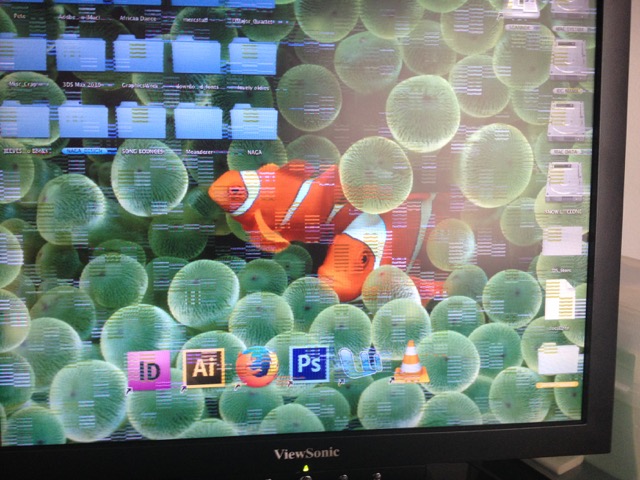

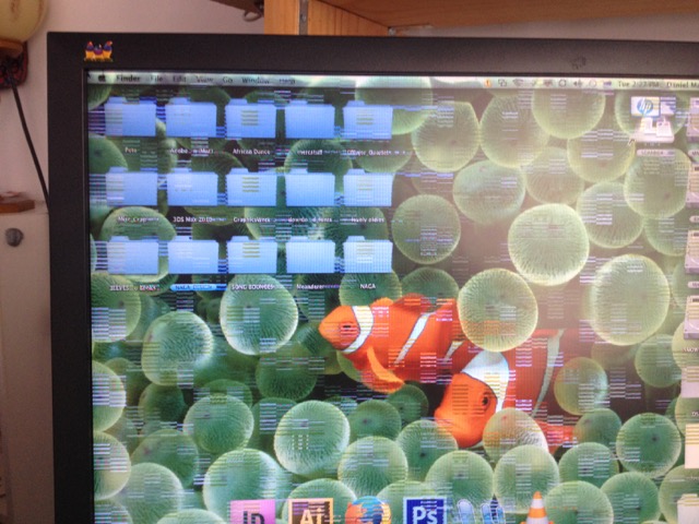

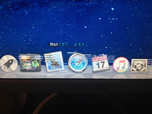

Hi guys,

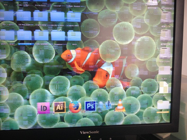

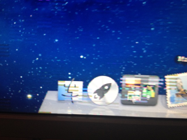

I'm looking for some expert opinion before replacing my graphics card.
I'm running a 2006 Mac Pro 1,1 with the stock NVIDIA GeForce 7300 GT. Recently decided to finally update OS to Lion 10.7.5. After that it started having some kind of graphical nervous breakdown...
Symptoms: Screen artefacts. Screen Freezes. All graphics have some kind ghostly streak horizontal shadow thing. Animated features in lion (eg. opening launchpad etc.) freezing/ going very slow. Black screen after sleep. Whole system running very slow. Freeze after Login. Freeze at Login. etc.
It does these things on the back up copy of my Snow Leopard System I made too. So I'm assuming it's not Lion.
Here are some pics:
There are some more pics and some videos here:
https://www.icloud.com/sharedalbum/#B0C5oqs3qijLfx
Here is an error report I got after one of many restarts:

Unsuccessful things I have done to try and fix:
SMC and PRAM resets (multiple). Disk Erase and Clean re-install. Disk Permissions Verify and Repair from Recovery Disk. Disk verify and repair. Apple Hardware test from original OSX boot disc. Diagnostic Led tests as per Service Manual. Air clean and re-seating of GPU and both RAM BOARDS.
All checks and tests reported that hardware is fine. Both fans are working. I'm learning a lot, but the computer is still behaving very badly. My next step is going to be replacing the graphics card...but before that I wanted to ask the learned folk here:
AM I MISSING SOMETHING? Am I right thinking the graphics card is the culprit? If it turns out to be the logic board - how hard is it to replace that? I see logic boards are available in eBay, and the instructions to install make it look do-able, but any experienced opinions would be welcome.

99.9% it's the GPU, so a new graphics card after 10 years of service is normal 🙂
[doublepost=1471559310][/doublepost]Also, do a test at the cable. Some times a bad connection or connector of the cable is the reason for this kind of artifacts.
0.01% to be this but I think we're 100% covered now.
it may be worth cleaning your GPU in case it's a heat thing.

If you want to fiddle a bit you can try the following:
Remove heat sink
remove thermal paste
remove thermal pads from the rams and put it back to the heat sink
apply heat with a heat gun for about 10 seconds per chip
I control the heat with a laser thermometer, not to exceed 180 celsius on the chips
let it cool down
give new paste (I use mx4) to the GPU and a small film of paste to the rams to optimize contact to the old thermal pads
and while you use your gpu again think about your next one as it won't last very long
I just reactivated two 8800 I had stored by this method, now stress testing with the heaven benchmark for hours.

Hi guys,
Thank you all very much for your replies/advice!
I feel pretty confident now that it is a GPU problem, and am going to replace it. Probably go with a 5770 or something similar. There seem to be a fair few used ones on eBay for around $130 AUD. I want to upgrade to El Capitan sometime soon and have read that I'll need at least 512mb card to do that. I'll probably "bake" the old one too and keep it for a back up.

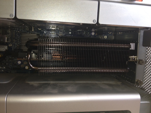

One step forward and one back I think…
So I finally got around to getting a new card - picked up this 6850 on ebay for $45:
http://www.ebay.com.au/itm/222315201304?_trksid=p2057872.m2749.l2649&ssPageName=STRK:MEBIDX:IT
It's an ugly mother with enormous cooling fins, but the price was right, and the guy was local and offering 60 days warranty.
Worked straight out of the box. Yay!
The elaborate fins do prevent it from fitting in the first PCIE slot. Which of course I have only just discovered is the only 16 lane slot. I got a pop up warning from the card utility manager thingy telling me to reconfigure which i did so slot 2 now has 8 lanes.
Would I notice much difference if I had it in the 16 lane slot? The guy has other cards and I'm wondering if I should exchange this beast for a slimmer model that will fit in slot "1".
Any advice appreciated. 🙂
