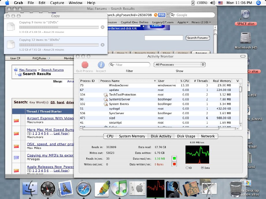

Here's a screen shot of my G5 acting like a slow POS. 🙁 Can any of you guys try a large network copy for me and see what you get for throughput? Thanks.
bz

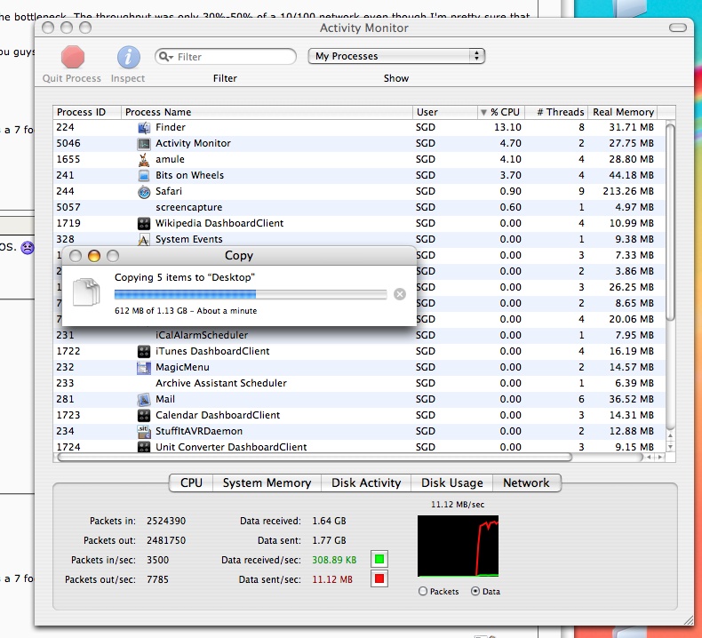

Just did a test between my PM G5 and my GF's iMac G5, transfer rate is about 10~11MB/sec. Both machine connected to D-Link DI-624 router with full duplex 100Mbps.
That's what I'm talking about! There's gotta be a break down somewhere. Could there be that much of a difference in going from Mac format to FAT32? Has anyone else done a large file network copy?
