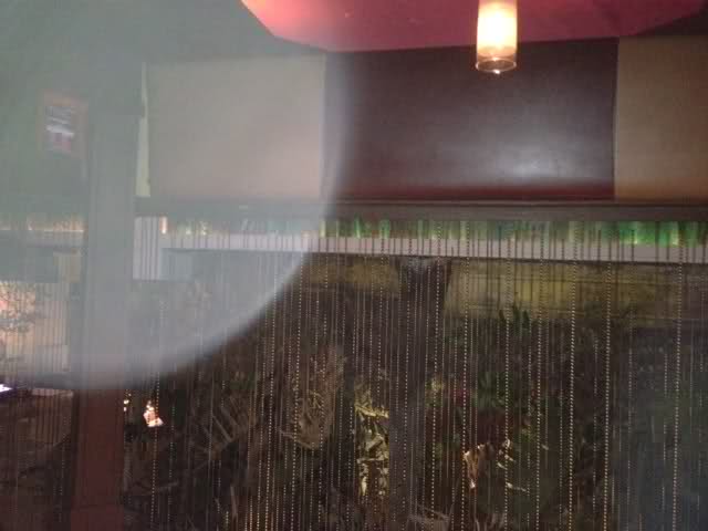

Every pic I take with my iphone 4S has this artifact when I use the flash. At first I thought it was the flash reflecting off of my Magpul case, so I cut out a bigger hole for the camera/flash, but the artifact remains. I assume this means that I have a defective phone, but I figured this'd be a good place to ask the question.
Example:
Is your case clear polycarb? If so, it's the case. I had to stop using my one case for my 4 because the flash would get washed out...it was clear polycarbonate on the back, and even with a large opening, the whole rear panel would light up when the flash was used.

There's no skin or film and I was careful to be aware of where my thumb was. I'll keep messing with it. I didn't remove the case between shots on that one, which I should have.
Yup, try without the case, with your hand COMPLETELY away from the camera/flash. That really looks like reflection artifacting.
I have a lime green "iFrogz Soft Gloss" case on mine, and have no flash issues.
I've only found a small amount of cases that don't have this issue. If I know I need to shoot w/flash, I take the case off.. typically, I shy away from the flash altogether, but it's a known issue..
Take the case completely off. Take a picture with the flash. View the picture. Picture good? goto "Throw case away". Picture bad? goto "Apple Genius store appointment".
