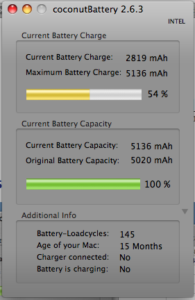

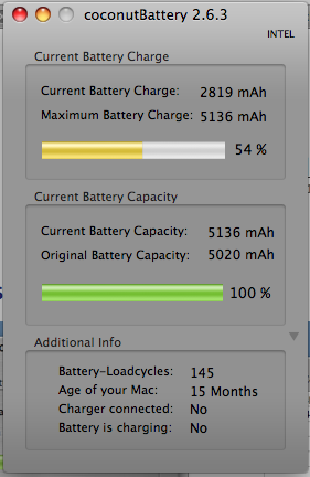

Dont worry.... CoconutBattery is as reliable as a Dell running Vista!
See my reports for example!:

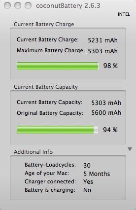

I noticed my battery capacity is now 94% of original, and several days ago it was 98%. I have been using the MBP normally - usually plugged in, but some of the time on battery. I don't always run it down to the limit, but have cycled it a couple of times all the way down, then recharged. My MBP is 4 months old. I'm concerned that it may be degrading faster than I would like it to. Can the battery be built back up by deep cycling it a few times?

My battery dropped to 95% by 15 load cycles, and has vacillated between 94-95 ever since (now at 110+ cycles). It seems batteries may drop off a bit rapidly at first and then settle.
Calibrating won't literally build the battery back up, but it will sync the battery's processor more closely to its actual capacity (IOW, your readings will be more accurate).
No. Lithium type batteries don't suffer from memory effect. No conditioning is necessary, such as with NiCad types.
By conditioning you're not altering the chemistry, but you can increase the lifetime (or decrease it) because the microchip in the battery will be better calibrated to its actual capacity. If it is initially reading low, then reading more accurately high does in fact increase lifetime.
Well, a couple of days ago I just ran my MBP on battery during the day, and at home used it until it hit 5% charged, and shut it down. The next morning I reconnected the power supply and charged it back all the way. I just checked the status, and it seems back to 99% capacity. I'm happy. 🙂
