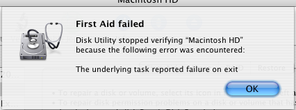

What the heck does this mean?
that might be the problem, but i have no idea what that means, b4 other smart ppl reply, u might search google for that error message. good luck
Make sure you are using the DFA disk that came with your OS - although you are intel, so you should be fine.
I got way funky errors using the disks that cam with the computer instead of the OS i had upgraded too.
But ya, go hunt around for help on that message/
Um, well, all of the google stuff I'm finding says to reinstall the OS...which I am NOT going to do. I've had this thing less than two months and this would be the second time. I've had it up to my eyeballs with this machine. If I seriously have to reinstall the OS, I'm making a visit to the retailer where I bought it and demanding something else because I am not going to continue having problems with this machine.

Ran disk verify and got the error message above.

Looks like your HD has hosed your filesystem.
I've had this kinda thing happen before, and it's almost always a hardware fault that propagates into a software problem. It could be a bad HD, bad HD controller, bad RAM (less likely) or a dying motherboard (also unlikely). I wouldn't call it a "normal" problem, but it does happen. Although I've never had it happen to me with new hardware like this, my overworked G4 tower is my worst offender ( I suspect that the power supply is struggling with all of my upgrades)
My recommendation is to back up everything that you can, run fsck by:
boot into single user mode - hold cmd-S on boot, a black unix screen with white text will appear
type: /sbin/fsck -fy
and hit enter.
repeat until you get no errors, or a message saying that the disk is unrepairable.
If that doesn't show any errors were corrected ... download a copy of memtestosx and run that to check your RAM. If the RAM fails, replace it.
The last thing is ... get a copy of alsoft's "Diskwarrior" and run that, it fixes all kinds of filesystem issues that the built in disk utilities won't touch. It's not cheap, but it's worth it.

Per AppleCare's advice, I used the startup disks to do a Disk Repair and it seems to be, well, okay. I am also going to run the extended hardware test and see what I find. I don't have an Apple Store, only an Apple retailer who wants to charge me for diagnostics if the hardware checks out okay...um, no, don't think so.

My MacBook Pro (CoreDuo) is also doing the same thing with disk utlility, and has done even after an OS Re-install. "The underlying task reported failure on exit". Apple have said they'll take it in on Saturday for the processor whine problem (officially recognised, wahay!) to have a logic board replacement, but the screen is also dodgy and all the battery might be dying, plus this disk utility thing which could be a hard drive related problem, so I may ask for a replacement...
