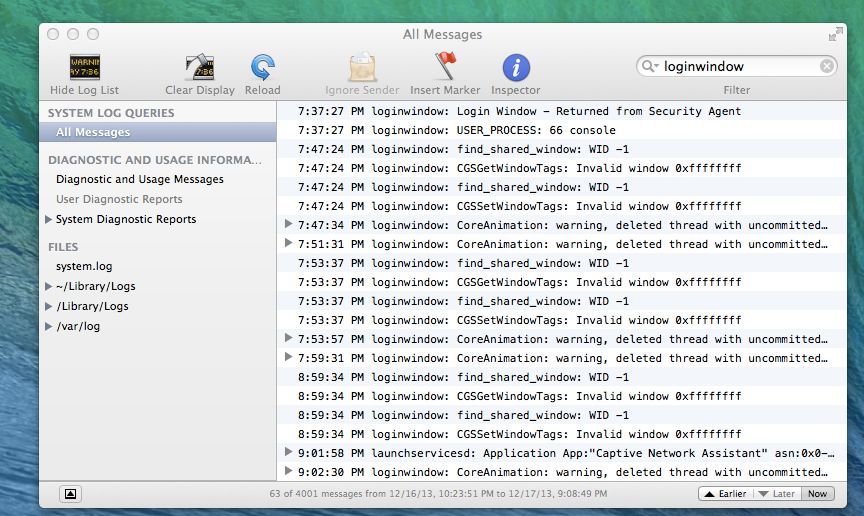

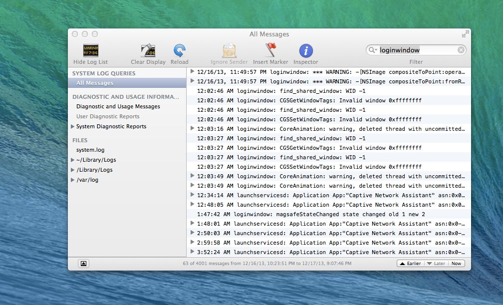

Okay so here is what I have, attached the images.

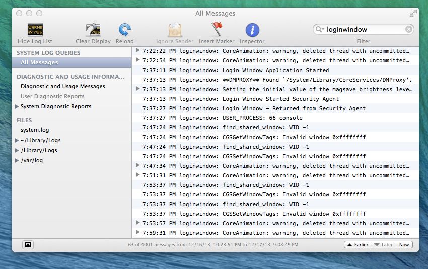

So when I log in to my mba from sleep or from shut down to on, where it says: Login Window Application Started, i take it this is referring to the time I logged on to my MBA right?
Because I logged on at 7.21 (i am certain of this today). I did have my MBA in the hour or so before 721, on lock mode via Find my mac on iCloud. What will the other lines before this indicate to, as my mba was on sleep mode, is it normal for it to run code on sleep mode? Last time I used my mba before 721, would have been before 01:00 in the morning of the 17th of dec 2013.
Yes, exactly.

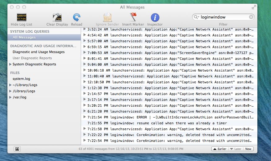

That is normal and what you are seeing is activity from Powernap that runs while your Air is asleep.

Okay thank you. I think I know what you mean. So if I understand is correctly and finally now and to put this thread to an end and for my own piece of mind. The way I read the console is that the earliest activity that started on my mba was shown at 111.49pm on the 16 of December 2013 and from that moment on because I had power nap on, all the other information is showed, and that at 7.21pm today i logged on to my mba. So my concern of someone in my house using my mba is not showing as the evidence is not showing before 7.21pm right?
You've got it. :)
If you don't see that any other login entries prior to your own, nobody logged in. It is possible to login then erase the log, but then you would not see those other entries back to December 16.
