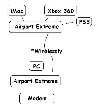

I have an Airport Extreme Base Station connected to my PC (which is not wireless). I am going to purchase an iMac this summer. Is it possible to connect two Airport Extreme's together, wirelessly, with only one router? The PC and First Airport is located in my Living Room. The Second Airport, the Xbox 360, the PS3, and the soon to be iMac, will all be located in my bedroom.
Why do you need a 2nd router (Airport Extreme)? Does the signal not reach your bedroom? Why not just use your current Extreme with your game consoles and iMac?
And if the signal doesn't reach then yes, you can use another Extreme through WDS bridging to extend your primary internet router.
