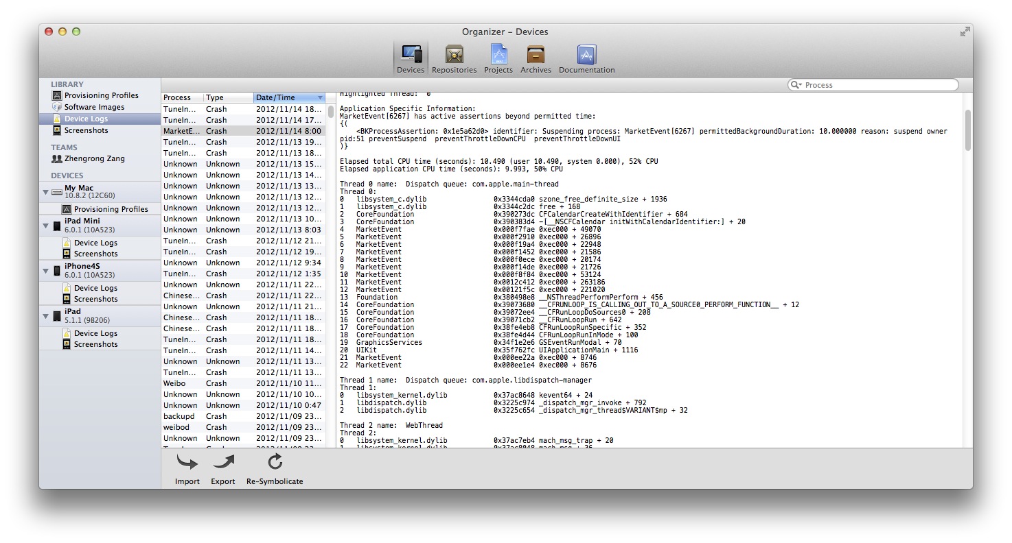

My app crashed and I got a crash log as attachment, I an not if this is symbolic log, what can I do if it is not symbolic?

This is not fully symbolicated - it's missing the symbols for "MarketEvent", which is presumably the part of the stack trace you're interested in.
This may be because XCode can't find matching debug symbols (dSYM) for this version of your app. Do you have the app (exact same version!) archived in XCode's organizer?

I run it in simulator and check it in organizer, I am not sure what I have to config anything else, can you tell me how can i get full symbolic crash report?
Was this an adhoc build? If so its dSYM file should be archived. If not then you probably don't have the dSYM file.

They added a re-symbolicate button in the Organizer. Sometimes you have to quit and restart Xcode for it to work though. In older versions of Xcode it's a little more complicated.
I tried to re symbolicate but no changing!
I have no way, does any help me?
