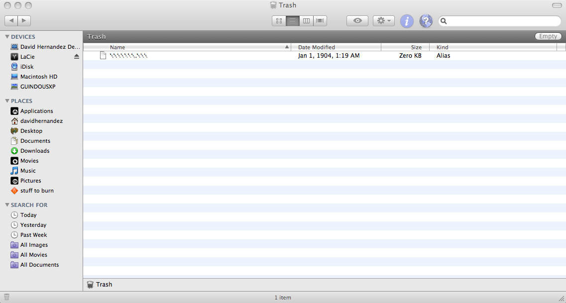

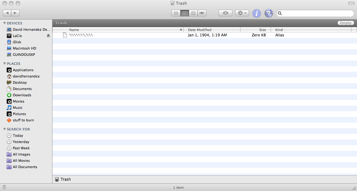

Ps. check on the attachment what my trash shows: a file modified on 1904!!!😱

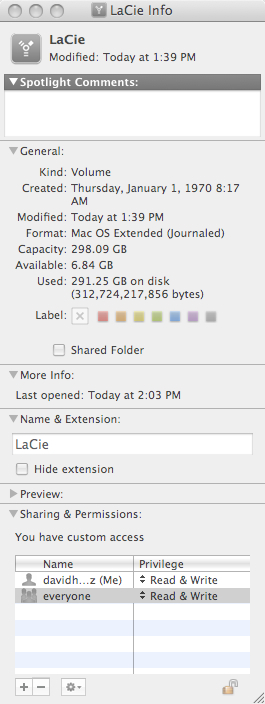

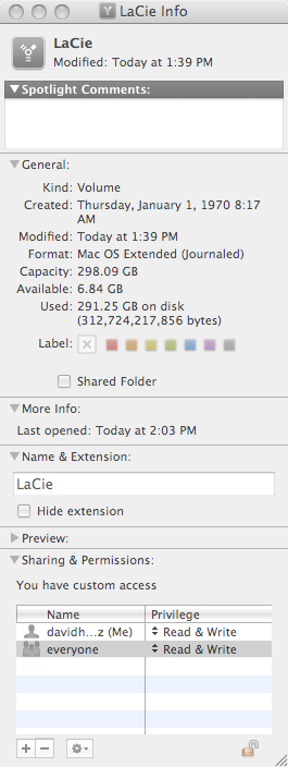

Still I can delete files from other folders from the ext drive...finder keeps telling me that I have insufficient priviliges for that...
Any ideas?...I guess I'm missing something...but I can'nt figure out how to tell to MY ext hd that I have write/read permissions on it...I can't delete files from it nothing at all...
