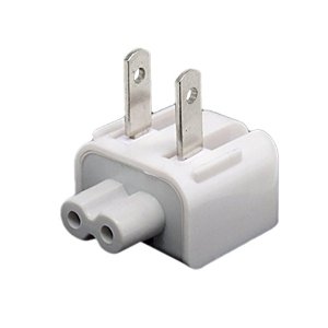

That's correct. In the box is:
  • 2m USB-C Charge Cable
  • 61W (13") or 87W (15") power adapter
  • A region-specific "duckhead" (see image)

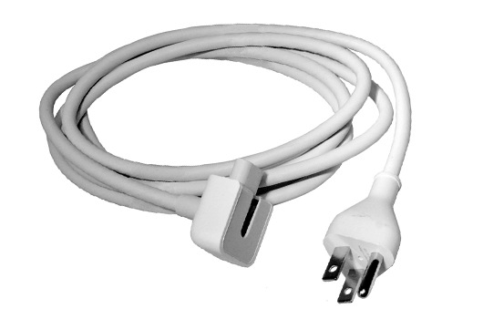

What is not included, but normally is, is the duckhead extension cable:
I think I have a couple of these to use with an early iPad but never bothered. Any reason they won't work with the 87w power adapter? The description says: "Use it with MagSafe and MagSafe 2 power adapters and 10W, 12W, and 29W USB power adapters." But it's just a power cable, so I it should work for all, right?
I usually keep one charger where I normally use my mac. I keep another one in my bag for use away. So I'd want the full assembly.
Yep it will work with all of them, the site just hasn't been updated yet.
Thanks.
