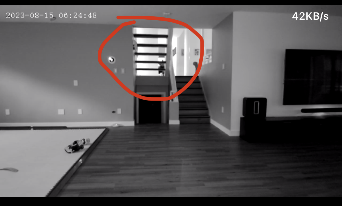

Ok, I gotchya. My G3 is facing a staircase from about 20’ away in my den. The steps are the floating type so the camera can see through them. It actually picks and detects people that it sees through the steps. I think it performs very well in that aspect. The only issue I have with the G3 is the camera angle isn’t very wide while stationary. I have mine set to human tracking, another feature that I think works very well. It’s funny that no matter where I am in the room, I look at the camera and it’s staring back at me.
I would suggest aiming it at any point of entry that a burglar might use and set it to human tracking. Unless this particular room you have it in has multiple point of entries, then you may need more than one for full coverage. Mounting in a corner would probably work best because of its narrow FOV.
This is the floating staircase I’m talking about:

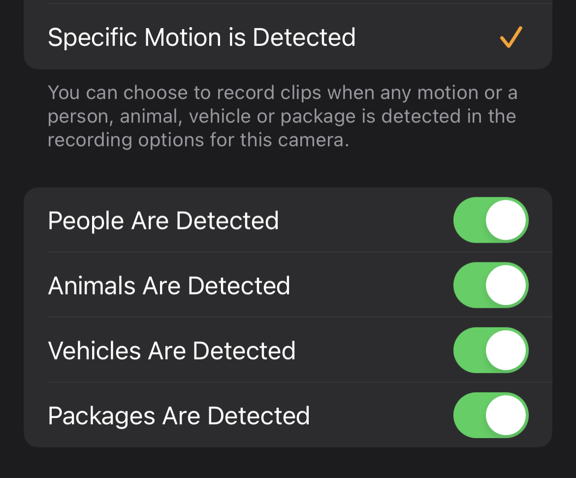

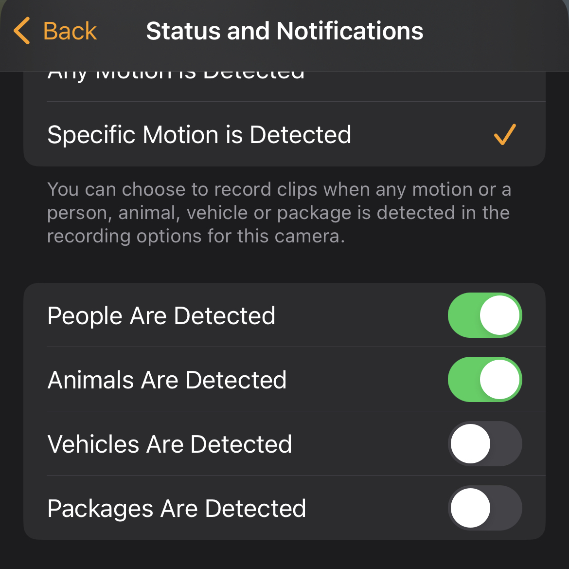

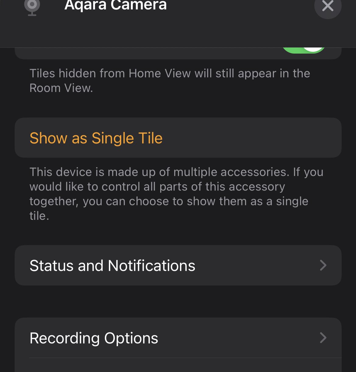

Hi, I though I would share what I finally understood regarding cameras on HomeKit:
1. The Notifications, Recording and Automations feature don't use the same motion detection settings.
2. I can't get any useful motion detection settings.
Here you can see separate configurations for Status and Notification and Recording Options.
For example, if you want to trigger motion detection for People and Animals, then you must do the settings twice for both Notifications and for Recording.

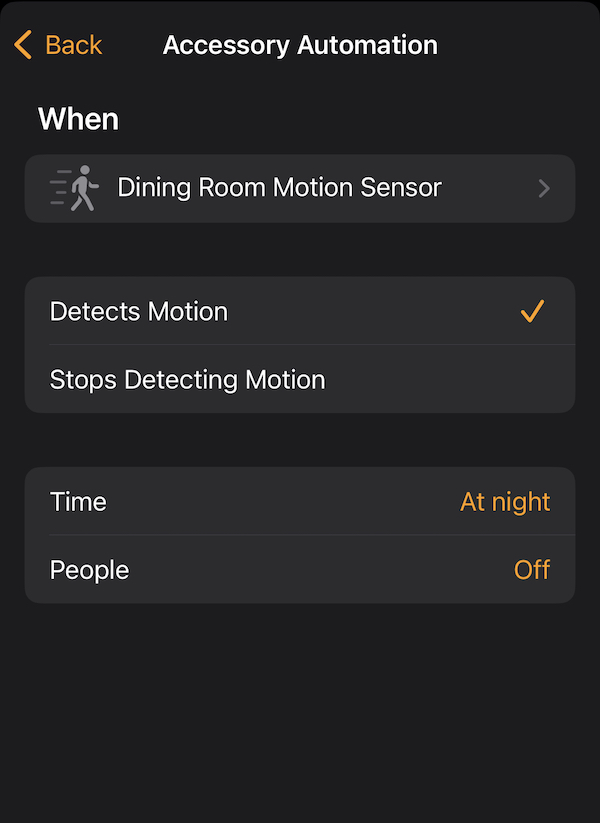

The worst part, is regarding Automations: you can't set Specific Motion parameters at all.
So first all these multiple configurations are quite confusing. I would expect a single motion detection settings.
And the detection itself is completely flawed. "People detection" works only when the subject is very close to the camera. So it's useless as a security camera inside the house. And the default "any motion is detected" settings triggers when the camera starts and when it switches to night mode.
In the end, I could not get anything useful. Either too many motion events triggered or none at all. Sigh 😒
