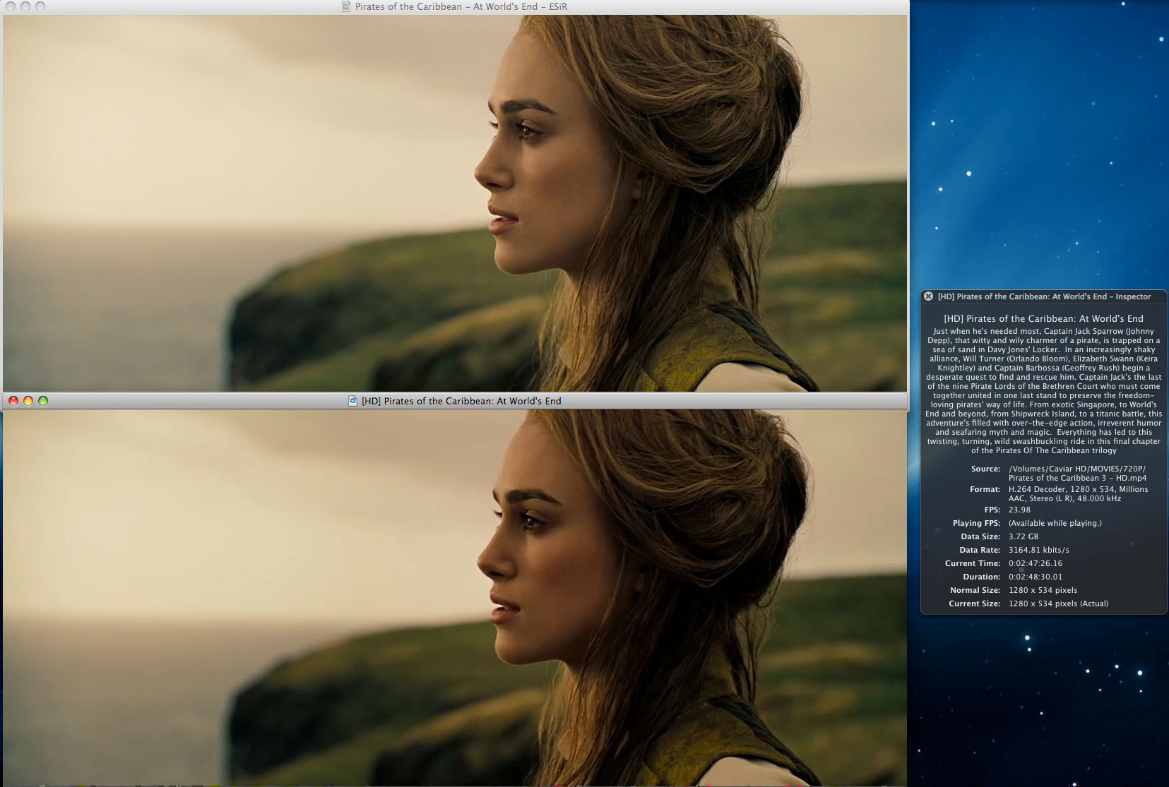

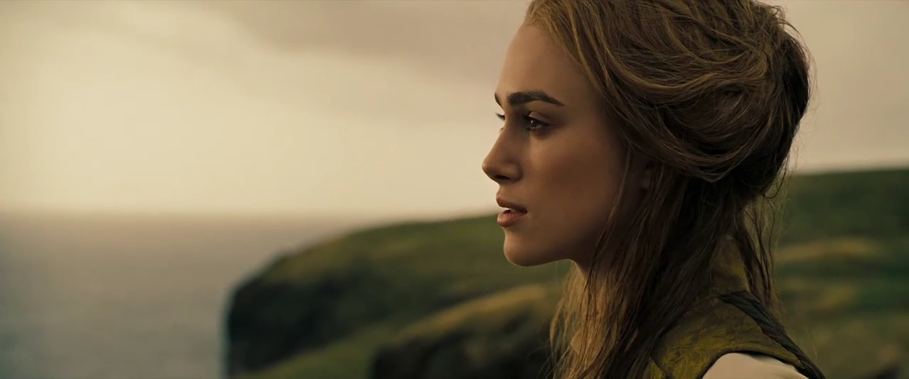

    I mean seriously isn't there something a little better? The quality is really rediculous and this setting was on "Go Nuts."
    [​IMG]
    I am going to try a little something new.. I am using the advance feature and putting in the original file size in MB and try "Two Pass." Will this help? Thanks!

    Comparing the two looks like your output res is lower...
    Use the custom settings if you are picky about that stuff...

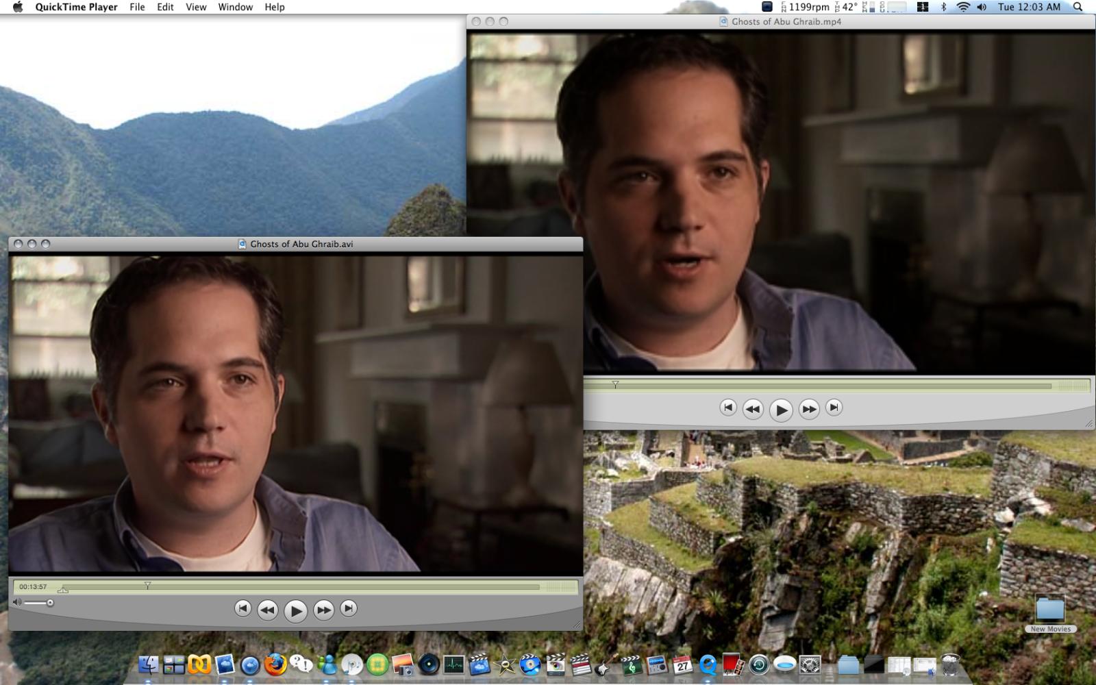

    No matter what program you use, you are going to loose some quality. But I am still very happy with visual hub. Until AppleTV can accept higher bitrates, you will lose some quality from the source. But it still looks great on a hi-def TV.

    The quality loss you are seeing here is becuase Quicktime plays MP4 files alot DARKER than other players. Open up your original DivX in VLC side by side with your MP4 in VLC and the quality will be alot more similar.
    Background: Quicktime has a bug when decoding MP4 files and causes the output to be alot darker than what it should.
    Keep in mind - your apple TV uses quicktime to play the files aswell :p

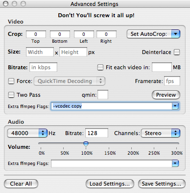

    Just choose passthrough for video so it doesn't re-encode, it should be very quick too.

    Here's the settings I use to convert an avi (XviD mpeg4 video & 5.1 ac3 audio) that I made in Handbrake before for my Philips DivX DVD set top player.
    The video is passed through and the audio encoded to stereo aac for playback on an iPhone.

    This works because Xvid is MPEG4 compliant, or vice versa or whatever, right? So you only have to re-encode the audio, and put the whole thing in a new container.
    I had always wondered if this was possible, I guess it depends on how the original video was encoded. I am gonna try this with a random vid right now...

    No. I think there are too many different encoding settings and other variables, so for any given clip may it will work, maybe it won't.
    For example, there are different profiles for H.264 encoding, and the iPods will play certain kinds (the more basic settings.)
