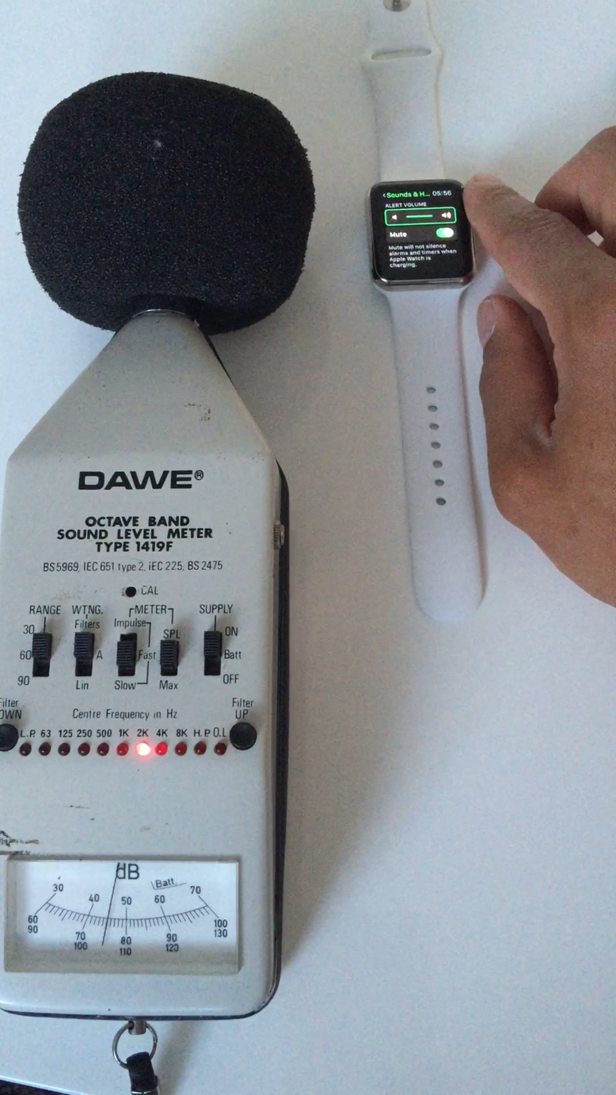

I thought my speaker was getting worse but turned out to be a side effect of getting the watch wet. After a night on the charger it was back to normal in the morning.
I even went as far as recording the decibel level of the volume 'click' with an old sound meter...
Before I was getting about 20db at max volume,
The next day it was up to 45db.
(Screen shot of the video I took for my comparison, Max reading was 45db at zero distance)
Anybody else got a sound meter and want to give it a go?
Thank you for that information. I guess no chatting while in the shower (and a while after) then.

Also my original concern was I find the speaker a lot quieter now then it was when I first got the watch. But Recognition (on the 2nd post) explained why I was getting different volume on the watch. I did shower before receiving that call, so concern is explained

I did shower with mine last night and then about an hour later my wife called and I answered it from the watch, and the the call was not as loud as it normally is, so maybe thats why, But you said yours went back to normal the next day? So maybe the next call I get I will see how it sounds.
I do not shower with mine often, I have done it 3 times, but this was the first time a call came in within hours after the shower.

If it's become more muted perhaps restarting it would resolve this. And yes keep water out of it.
