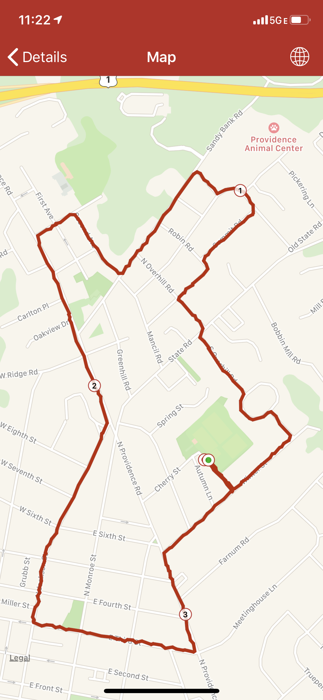

Note that on all of the runs, the map that is generated is fine. It's just that the mile markers are showing up 3 to 5% sooner than they should.
Here's and example:
I just noticed something when looking at the two route maps above. The bad one (#1) is very jagged whereas the good one (#2) is relatively smooth. I wonder if something changed in iOS 13 that reduced the amount of smoothing going on with GPS reliant maps???
I decided to look at the maps of the runs prior to updating to iOS13 and the ones after. All 5 runs after iOS13 are noticeably more jaggy than the ones before.

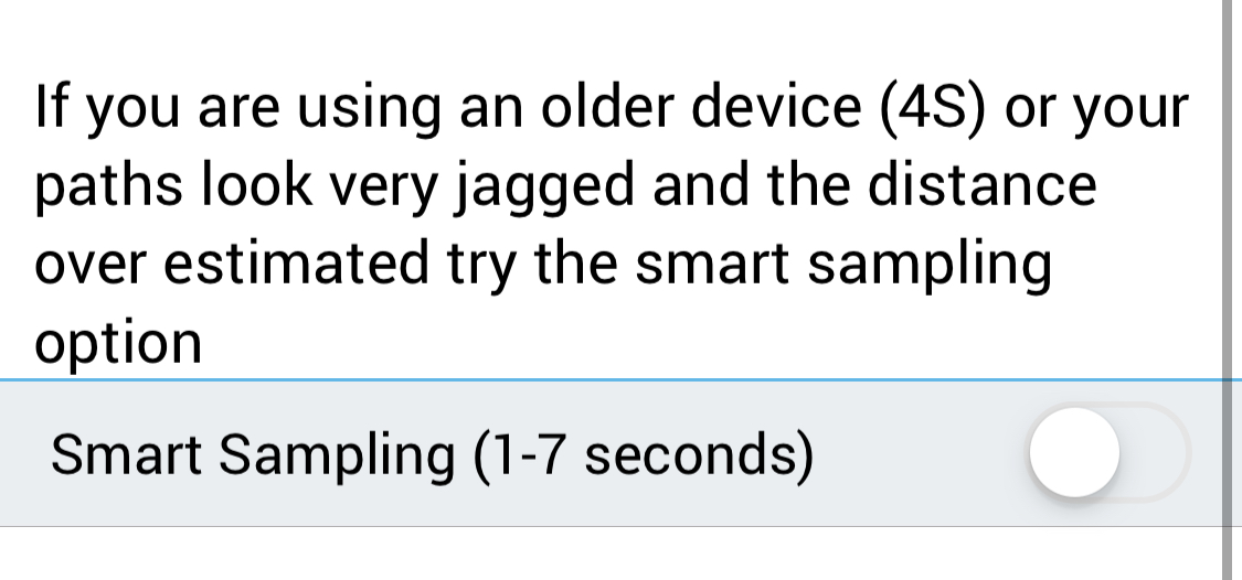

There's an option in iSR for Smart Sampling that looks like it may help.
Final Update
I went on run this morning using iSmoothRun with the Smart Sampling option turned ON.
My route typically records as 3.3 miles and using the USATF mapping function, it shows as 3.27 miles. Finished the run and it logged as 3.28 miles. The mile markers showed up in the expected spots.
I'm going to classify this mystery as solved. Although I don't know what changes occurred with the update to iOS13 that affected the way iSR uses the GPS data from my iPhone, I do know that the Smart Sampling feature solved it.
I guess if you're having issues with your running app overstating your distances, check to see if they have a feature that smooths out the GPS waypoints so that it's not thinking that you're zig-zagging all over the street.
