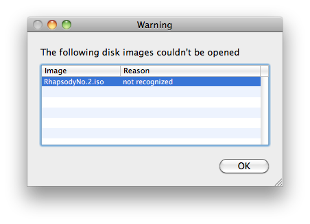

O, I forgot, I get this error: image not recognized, see attached picture.
