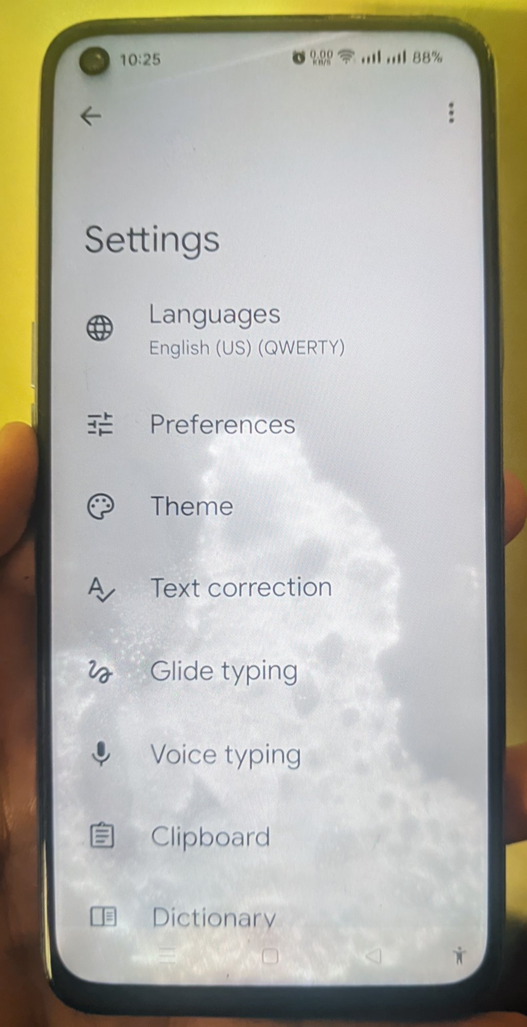

My device also have wet spot because i put 98% isopropyl alcohol in it

What worked for me was using my hot air station set at 190c using small nozzle,heated between lcd and digitizer until screen went black in the heated area and used a microfiber cloth gently stroking it up to the top and rinse and repeat only doing a small area at a time. Surprisingly worked!
