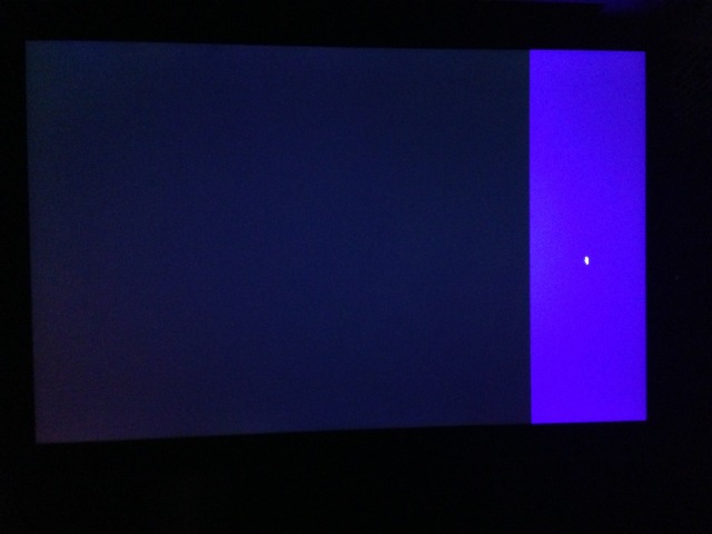

I have tried twice installing windows 8 pro onto my rMBP via bootcamp but failed both times.
After the step "Getting files ready for installation" completes, my macbook restarts as expected - launches back into the windows installation however the screen goes black with a purple stripe (see pic). The cursor is visible on the purple section however it looks squashed.
I deleted my bootcamp partition and tried again with the same result.
Am I doing something wrong?

Reboot Windows 8 in safe mode. (While win 8 loads hold down the Fn + F8 keys). Windows will then go to "Advanced startup" Choose "Troubleshoot" and "Advanced options" click "Startup settings" Choose "Enable low resolution video mode" When its done, Windows will magically restart normally and be ready to set up user account and install drivers.
Windows 8 just doesn't know what to do with the retina display resolution on some MBPr's yet at boot.

I had the same issue- there are two ways around it.
1- plug in an external monitor for set up
2- install ntfs for mac and you need to access the windows partition and delete the standard display driver file, when you restart into windows it repairs its self and all is good. ( I did this method as I didn't have a monitor, however I can't remember the name of the file, I googled things like "windows 8 install MacBook retina blank screen" and I eventually found a thread on another forum describing how to do it)

Found it: install paragon ntfs free trial and follow these instructions:
Part 3b: Fixing Windows 8
For me, I experienced the black screen issue, where it would just sit there forever. A fix for this is to remove the igdkm64.sys from C:\Windows\System32\Drivers.
I just trashed the file and emptied trash and then rebooted and it did a quick repair process and voila!
heres the original link if you need it
http://thetecherra.com/2012/12/11/tutorial-install-windows-8-on-a-mac-via-native-efi/
