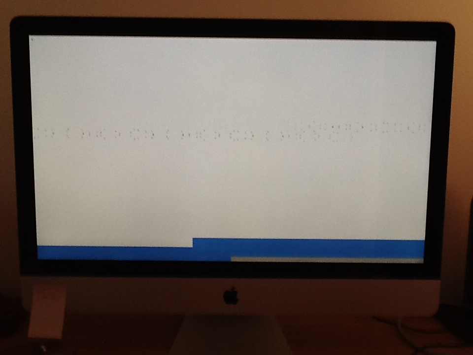

Anyway, I have a problem with my iMac. When I boot the computer, the screen is noisy (the screen freezes white and there are strips of pixels across the screen). I can move the cursor, however.
A friend suggested to start in safe boot and move ATI extensions elsewhere in order to boot normally. And it does so. However, I cannot play videos.
I did a clean install and updated fully but no luck.
Is this a hardware or software issue?
Please guys. I really need your help 🙁
[Update]
I completed an extended hardware test with no error.
Are there other tests I can do to find the problem?
Also, I added a photo to show the problem:

Can you give some more information?
Which iMac (21 / 27-inch)
What version of OS X
How much RAM is installed? Have you recently upgraded your memory, or changed any other hardware? Good first step, I think, would be to try reseating the RAM, and check to see if that helps. If your ATI extensions are still out of place, you should also reinstall your present OS X system, again. If you are presently running 10.10 Yosemite, then you should consider that version is not finished, and may be your problem...
Sorry to say, but it appears to be a graphics card issue, something iMacs are notorious for having. Chances are, your iMac was running hot and ruined the card. Unfortunately, you may have to replace the entire logic board. If that's the case, you're probably better off replacing your iMac or get another Mac or PC because the cost for parts and labor is almost as much as a new computer.
Hope I'm wrong, but your symptoms are typical. Good luck.
P.S. Have you tried the freeware download, "smcFanControl?" Once installed, you can control the fan speed (make it higher or max) and it might be a temporary measure for cooling you mac and improving the graphic performance. If it works for you, it will work for a while, and eventually the graphic card will crap out, but it will give you some time to use it and upload/transfer files you need to save.
Once it craps out, you'll have to move or delete the ATI files in order for the computer to start (other than safe mode), but you won't have video, ie. youtube and flash, though QT may still work).

nzgin, I see exactly what you have posted in your picture above on my 2009 iMac and have also seen it on other iMac models from 2009 the ones listed here.
It's only present during bootup for a few seconds before the login screen appears. On the iMac's that I've experienced this on. My 2009 iMac only does this in Mac OS X 10.6.8 for a few seconds during boot when I start up in OS X 10.9.4 the issue is not present. It's also no longer present on the iMac's that I have upgraded to a later version of OS X for clients.
nzgin, Does it disappear after bootup or is it like that all the time?

As mentioned if you're only seeing what you posted in that picture during start-up in my experience it disappears completely when running a later version of OS X then Mac OS X 10.6.8.
I also haven't experienced any other graphics card issues once the computer has booted even when running Mac OS X 10.6.8.

Interesting, Going back to your issue on the earlier version of the OS are you saying what you see on the screenshot never disappeared? As for me it only lasts for a few seconds then I get the login screen?
However, I have a new problem: finders turn black and app icons flicker when I mouseover them 😕
Interesting it's definitely sounding like a graphics card issue. I'd be curious if you go back to 10.6.8 if the issue disappears again and you have the issue you had earlier.
As mentioned I see what you posted in the screenshot for a few seconds when booting into 10.6.8 then the login screen appears for me. If I then restart and boot into 10.9.4 am having no issues.
Very interesting wondering if this is a symptom of a failing graphics card issue or if there is a graphics card driver issue.
This is very likely a hardware issue. Artifacts and flickering graphics are often signs of a graphics card on it's way out.
Yes I'm well aware of that, but I'm only experiencing what was posted in the screenshot above in 10.6.8 for a few seconds before the login screen appears and I have been seeing that screen for at least two years now. With no issues under a later version of OS X.
Trying to determine if it's a symptom or an unrelated similar issue that I'm experiencing to nzgin or if I have to look forward to future problems similar to what nzgin posted later and posted here.
Regardless looks like I'll be doing some stress test today on my graphics card to see if any other issues pop-up. Unlike the other posters in this thread I can get a replacement under statutory warrantee over here.
