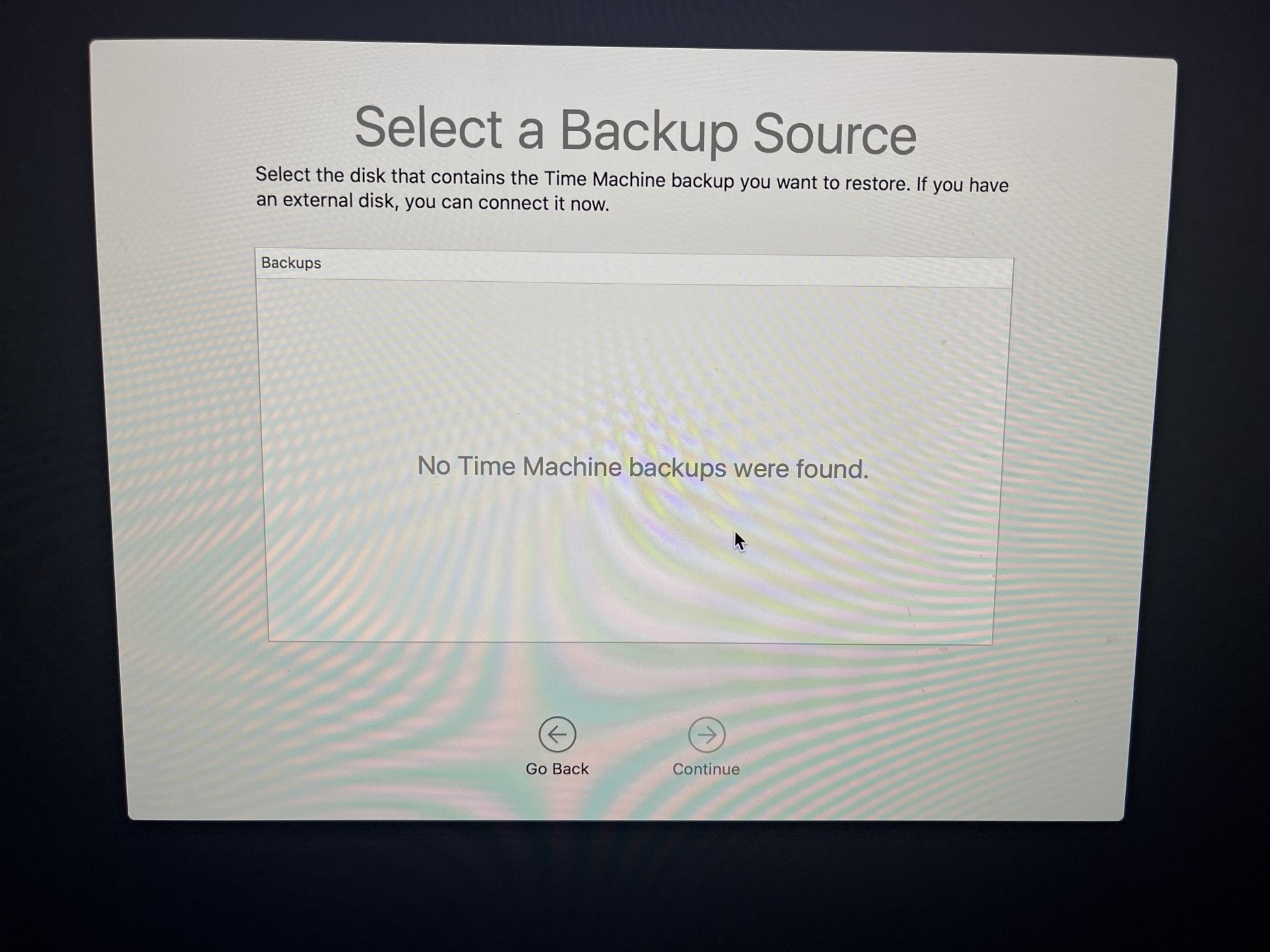

I erased my iMac 2 days ago since someone wanted to buy... anyway, they decided to cancel and I wanted to restore from a time machine backup. However when I start the computer in recovery Mode Time machine does not see any backups to restore...

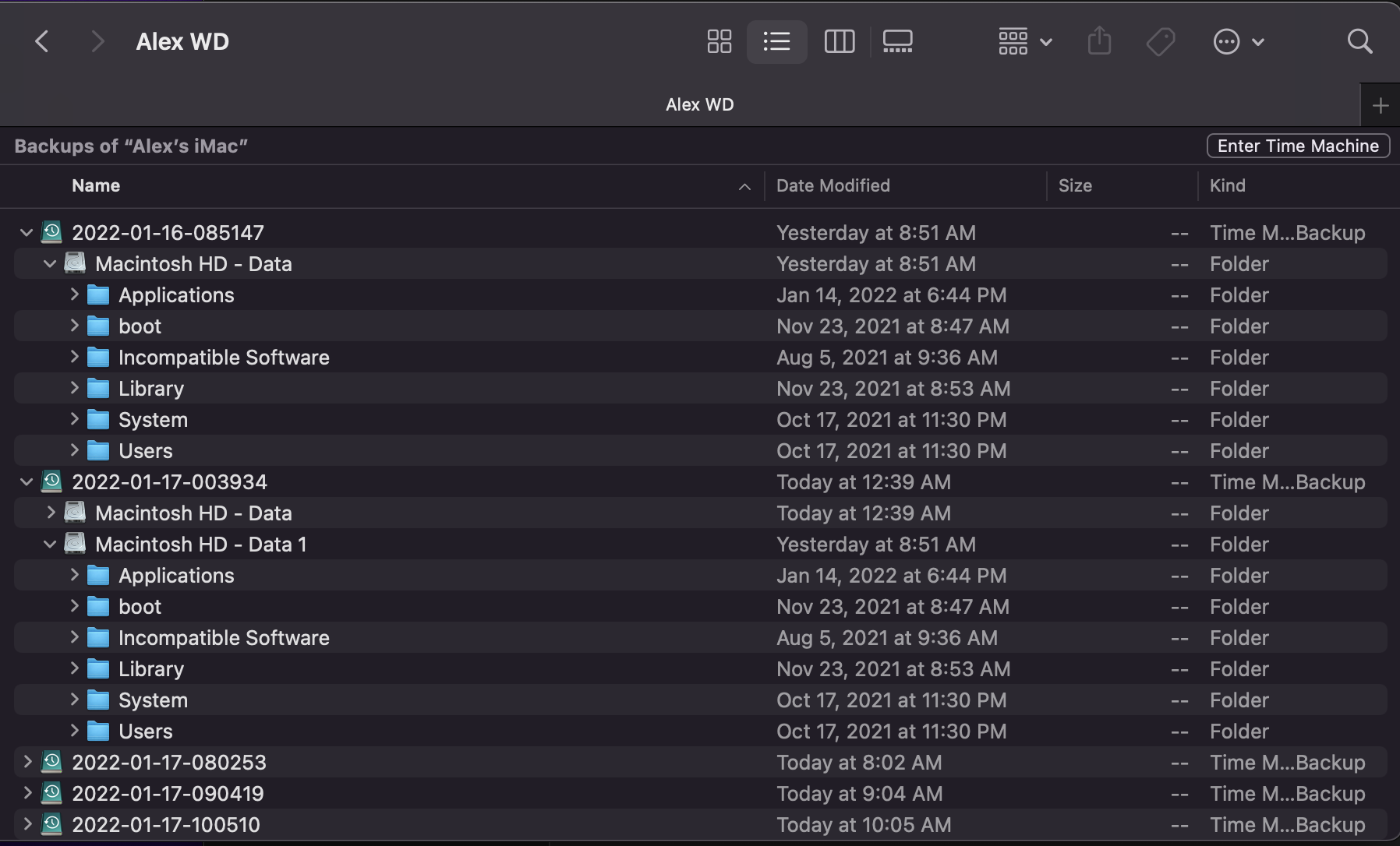

I started up my computer and my time machine looks weird... I don't see that normal the backup folder... that is what I see bellow...

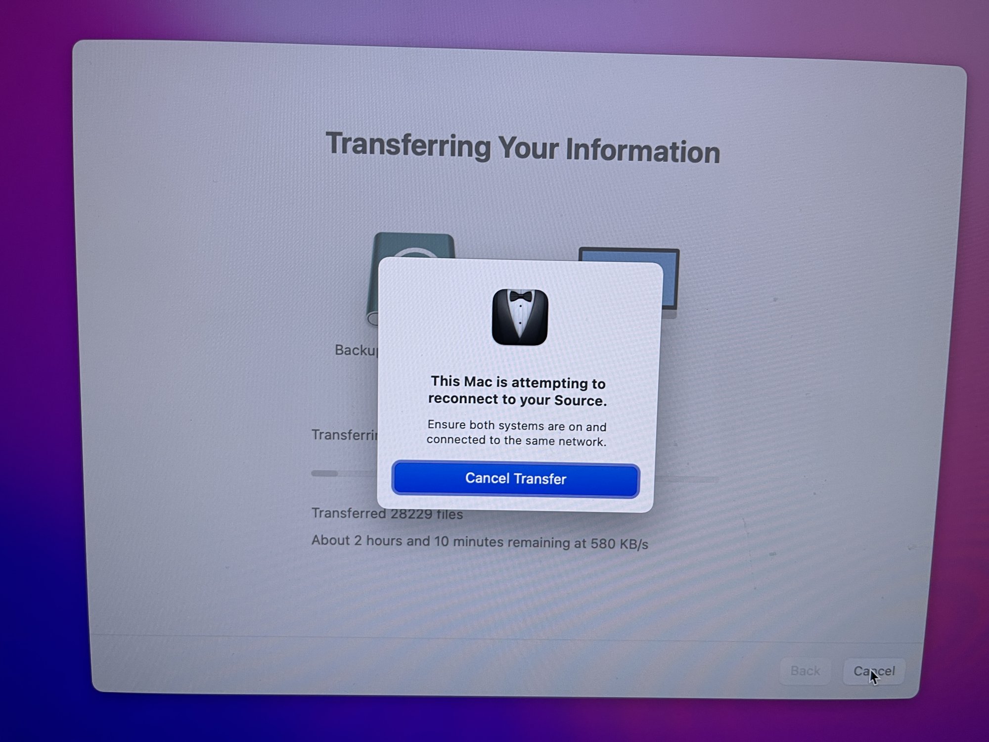

I also tried using Migration Assistance, which finds one of these backups, it stats restoring but after 5 min I get a message saying, "Computer is trying to reconnect to the source, make sure both systems are connected to the same network" but this does not make sense, since I'm not connected to another computer only trying to recover from a backup.

The looks normal except that there should not be two Macintosh HD - Data volumes. That suggests you didn't properly erase the drive before installing for your prospective purchaser. You should be able to restore from the 2022-01-16 backup snapshot. Does it contain all your old data in the Users folder? Does Disk Utility show two Macintosh HD - Data volumes? Or the output from terminal command 'diskutil list'.
Don't erase anything until you are sure that your user data is in one of the backup snapshots.

Your MBP is using an HFS formatted disk for TM, your iMac is using APFS. APFS is the default for new TM backups for Big Sur and Monterey.
With APFS format, each TM backup is an APFS snapshot (with its own TM icon). It is less liable to corruption than HFS format, because HFS uses directory (and file) hard links to avoid duplicating files.

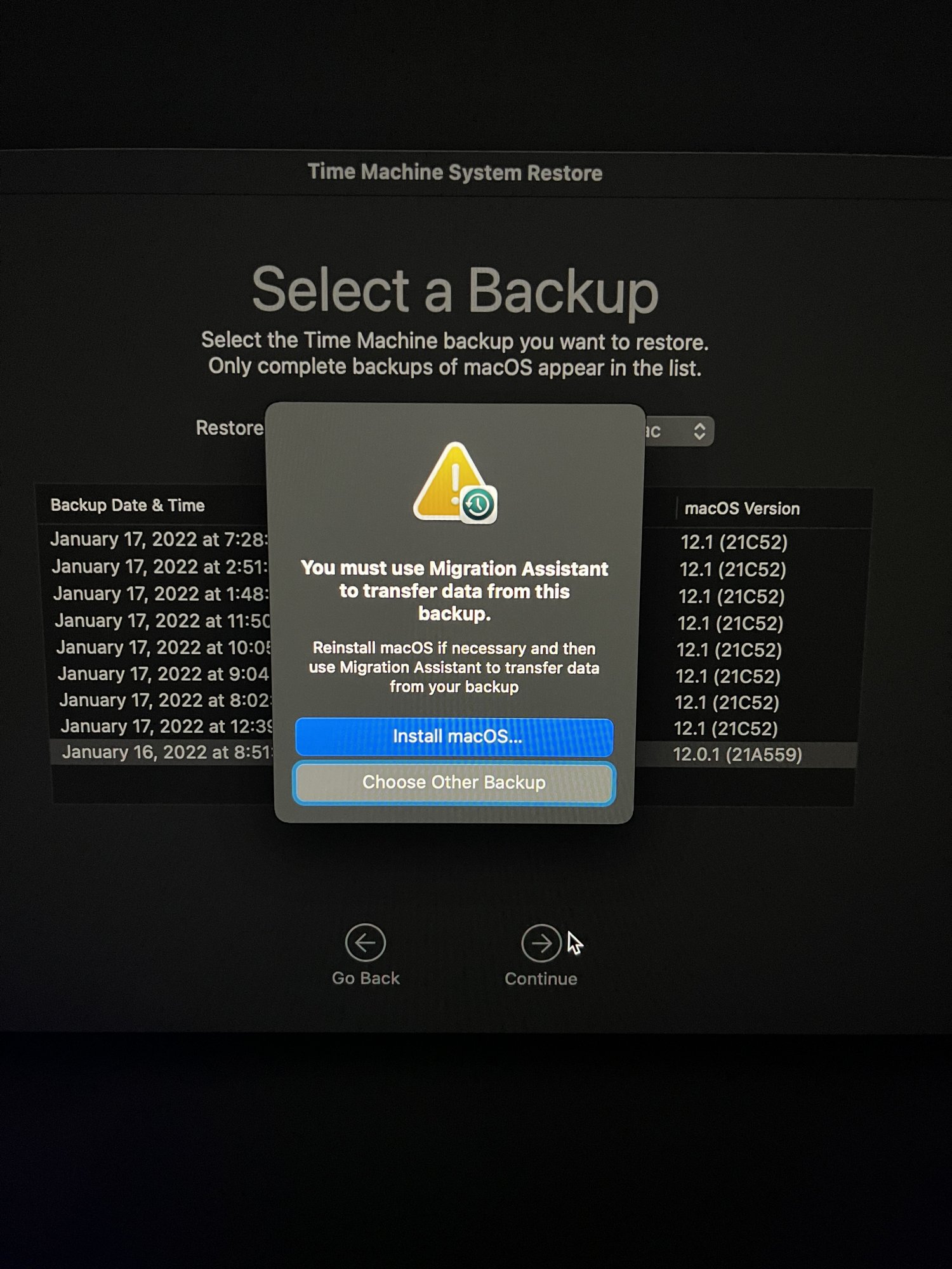

Ok bottom line is I can’t restore from Time Machine backup. I tried tonight several ways. Formatting in Extenlded Journaled, APFS, from a bootable Flash Drive, from Recovery…. Everything. When trying to restore from backup “I get a message that I must use Migration Assistance after install the OS to recover my data” When I try to use migration assistance I get an error message to reconnect my source and it creates an additional Volume called “Macintosh HD Data” and it gets my computer all messed up!!!

Your boot disk should have one APFS container with multiple volumes, the main ones being a) Macintosh HD which is a read only encryptically signed volume (so it can't be changed) containing just the operation system files, and b) Macintosh HD - Data which contains everything else. The presence Macintosh HD - Data 1 as well is an indication that something has been messed up in the recovery - most likely that the disk was not erased fully.
TM does not backup Macintosh HD. When recovering, it expects this to be either be present already or downloads it as part of the installation.
You can always boot to Internet Recovery (hold Command+Option+R when powering on). This will download recovery from Apple. You can then erase the disk (not just volumes), install macOS and as a final step restore from one of your Time Machine backups. The last step will restore the read-write parts of macOS, Applications, settings and user data.

Yesterday I erased the disc again, the whole thing and not only individual volumes. Then I have done exactly like that in terms of recovery but again when restoring from Time Machine I got the same error I got from recovering from migration assistance. It says it’s trying to reconnect to source and make sure it’s on both network. ?!?!?!?
Ok so it seems I found a painful solution
I’m using Migration Assistance. Every time that messages prompts about iMac looking for Source bla bla bla. I have to disconnect the USB cable from external HD to the computer and reconnect. The restore then continues for about 3 min or about 20.000 files transfer and I repeat the process. Sucks
